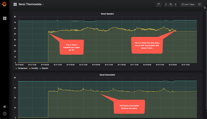

I have recently noticed that OH will stop getting any data from my thermostats for days at a time. Like right now it hasn’t gotten an update since Aug.10. The behavior is the data will get stuck on one set of values and never update again. In the past when I saw this I would restart OH and I started getting data again.
I will install your latest jar and see if that behavior changes as well as whether the humidity stops bouncing around.
Thanks!
Hi Joel,
The new jar worked great for the past five days. Temps and humidity all reporting in within seconds in the right units. However, the data feed has now stopped. Here is a screenshot from my Grafana.
How can I begin helping troubleshoot?
Do you see any wink related error messages that show up in the log around the time it stops?
