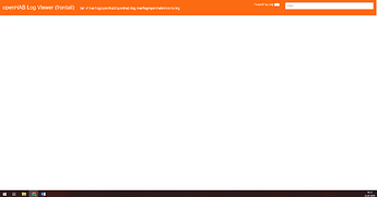

Empty log in fresh installation
openhabian on raspberry 3b+
after “dispatching event to subscriber takes more than 5000ms” striked again, i decided make a whole new setup.
Everything works fine but i dont get any text through frontail.
  • i checked the path (/var/log/openhab/openhab.log /var/log/openhab/events.log) it is correct but i have 8 files for openhab.log and 8 files for events.log. And none of them is empty.
  • i upgraded everything from openhabian-config
  • i checked the frontail.services and everything seems to be okay
