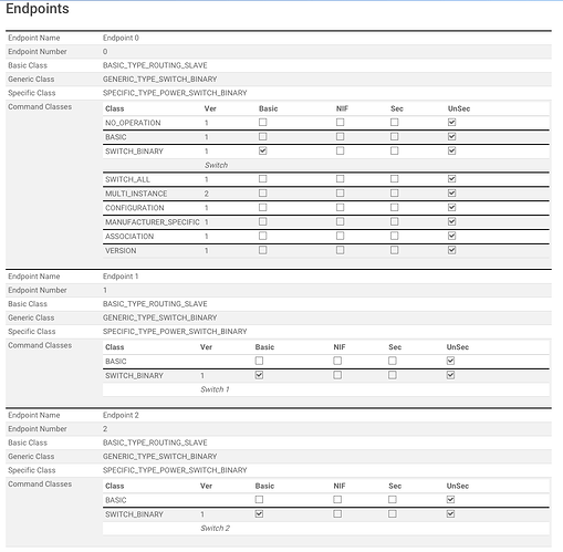

When I look at the zwave database at Chris Jackson’s website, I can see that Fibaro Double Switch has endpoints 0, 1 and 2, but in Habmin all I see is endpoint 1 and 2. Does the endpoint 0 perhaps have something to do with this problem? Could the solution be about being able to send to endpoint 0 some how?

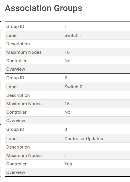

You can’t. Group 1 is for switch 1, group 2 is for switch 2.

Just below the part you took a screenshot of is a list over endpoints, and the enpoints are counted 0, 1 and 2. And in Habmin it is endpoints that are associated from one unit to another? And the endpoints on the Fibaro Double Switch is 0, 1 and 2, even though the association groups are 1, 2 and 3. Could that have anything to do with this strange behaviour?
Sorry, no idea. I don’t use direct associations but recently in another thread had to test it with a FGS222 and it worked fine. As I don’t have a wall controller I am not of any help here.
