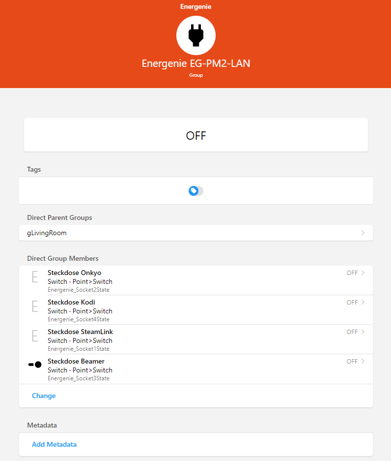

Hey guys.
I didn’t have any issues with the Energenie Binding until I upgraded to OH3 and the latest binding.
I removed the old binding from the textual files and added the new thing (and items) through Main UI.
When I switch on a socket it actually does get switched on, but OH sets it to OFF again immediately.
16:52:14.150 [INFO ] [openhab.event.ItemCommandEvent       ] - Item 'Energenie_Socket3State' received command ON
16:52:14.180 [INFO ] [openhab.event.ItemStatePredictedEvent] - Item 'Energenie_Socket3State' predicted to become ON
16:52:14.199 [INFO ] [openhab.event.ItemStateChangedEvent  ] - Item 'Energenie_Socket3State' changed from OFF to ON
16:52:14.330 [INFO ] [openhab.event.ItemStateChangedEvent  ] - Item 'Energenie_Socket3State' changed from ON to OFF
Also when I use the webinterface of Energenie and switch sockets off/on, OH doesn’t recognize it.
You can see how it’s set up here:
Do you see anything suspicious here?
Thanks in advance.
Yes, there is a bug in my binding. Use PMS2 as your thing and it should work…
Perfect! Thanks a bunch for the swift reply!
