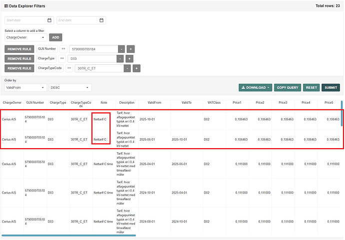

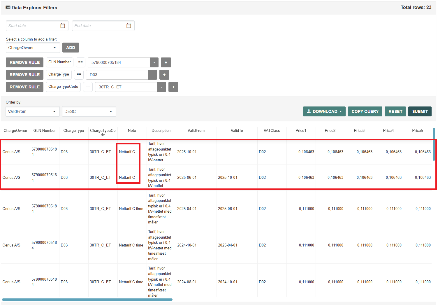

OK, this has been broken for you since June 1st, where Cerius made a change in the way they publish their prices:
I have updated the filter here:

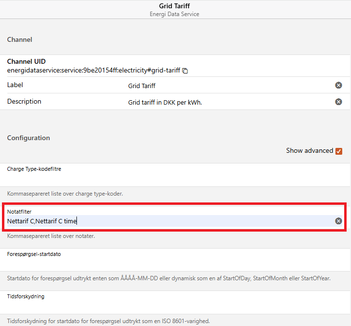

Until next patch release, you can configure your channel to accomodate for this change:
For file-based configuration, see Energi Data Service - Bindings | openHAB and Energi Data Service - Bindings | openHAB
