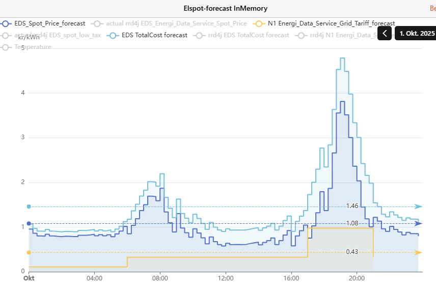

I can see the spotprice for DK1 is in the new 15 minutes interval from 1. october.
Is there any option to keep / get the hourly spotprice for a while, until N1 allows for 15-minutes spotprice on my adress? To my understanding, the “old” 1 hour spotprice should be the average of the four 15 minutes periods for that particular hour.
Yeah, we got lucky with the transition to the new dataset, which seems to work. :slight_smile:
The old dataset is now discontinued, see the news quote in [energidataservice] Add support for day-ahead dataset with 15-minute resolution by jlaur · Pull Request #18695 · openhab/openhab-addons · GitHub
I have the same understanding, but don’t remember where I read that. I need to verify, and then think about the best way to provide such a calculation, i.e. whether to build that into the binding itself, or whether it can be accomplished in an elegant way outside of the binding. I’ll get back to this thread regarding this. I don’t think my contract is automatically changed to the new resolution, so I probably have the same need.
Here is how Andel Enrgi handles 15min vs 1hour price: Andel timepris vs 15 min
”… Fra 1. oktober beregnes timeprisen på TimeEnergi som gennemsnittet af de fire gange 15 minutter i den pågældende time. …”
