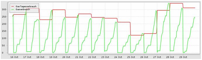

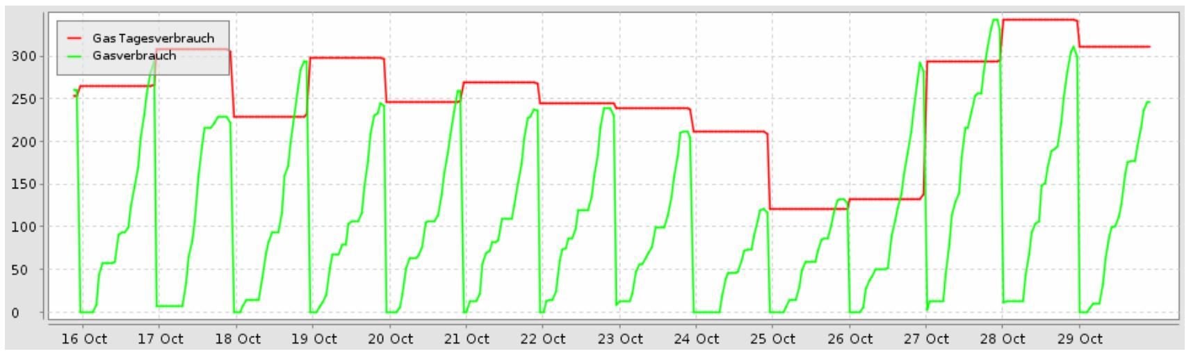

i just set the “temporary” number to 0 after i write the value to the “daily” number.
here is my chart (2 weeks timeframe):
green = the temporary value, growing all day
red = the final daily usage
the only “problem” with this approach is that the “total usage per day” is optically shifted one day to the right.
