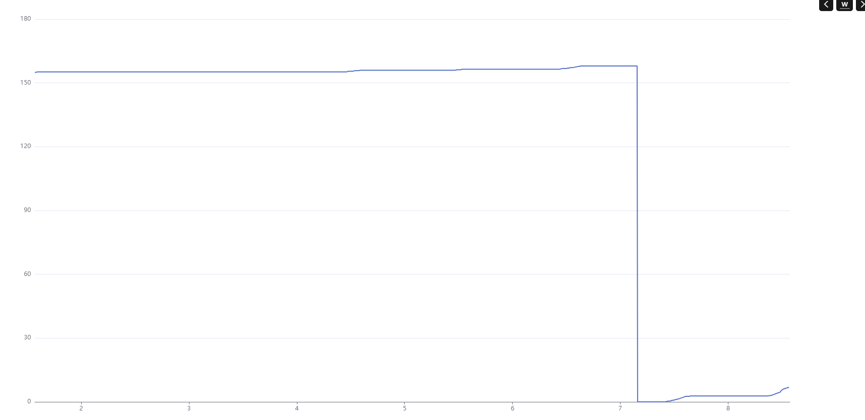

I have a item where is value of the energy consumption normaly still increasing.
But when there is power shut down or unit restart, this counter start again from zero :

As example. from 0:00 till 8:00 value increased from 200 to 250
Then there is a reset to zero and till 10:00 when calculation is done increased to 20
My function will show -180 (20-200)
but
Real consumption is 70 ((250-200) + (20-0))
