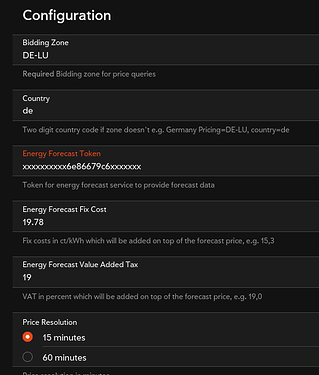

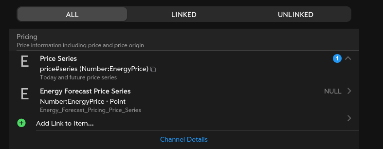

Nein, sorry, ich bekomme keine Werte.
Ich habe die Items und die Verlinkungen gelƶscht. Habe das Add-on entfernt und erneut installiert.
Ich habe die Werte in die neue Maske eingetragen. Auch einen neuen API Key erstellt.
Which persistence is attached to these items?
Rrd4j cannot handle future values. If you don’t have any other you can use inmemory

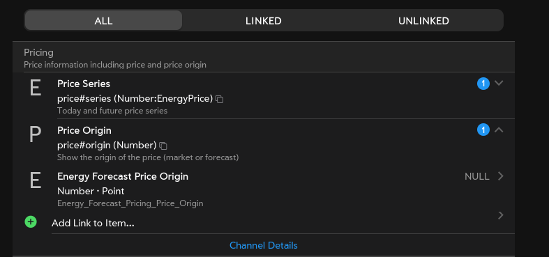

And one more thing - the format of the Price Origin channel is currently a Number which stays NULL. I guess that shall be a String, no?
That’s true, it’s a bug.
Fixed now, should work without creating new things/items.
No, it’s a number but with a human readable mapping - see readme.

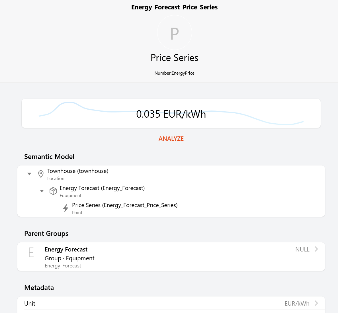

Regarding NULL - I’m also struggeling with timeseries first time setup every time! Item stays NULL until the next value update. In this case next full hour or 15 minutes. I still don’t know why the items doesn’t get filled immediately.

yeah, I saw the readme meanwhile. Is there any particular reason why you go with a Number and not a String to show the origin directly? In the JSON I can see the origin as a String when pulling from the API Webpage.
I opened a separate topic for the time series issues - here: A few issue with time series. No response yet and not sure whom from the Maintainers to ping..
Several small reasons
  • not easy to compare - ignore case sensitive, typos, …
  • standard rrd4j database cannot store Strings
  • with the state options mappings described in readme a translation is possible

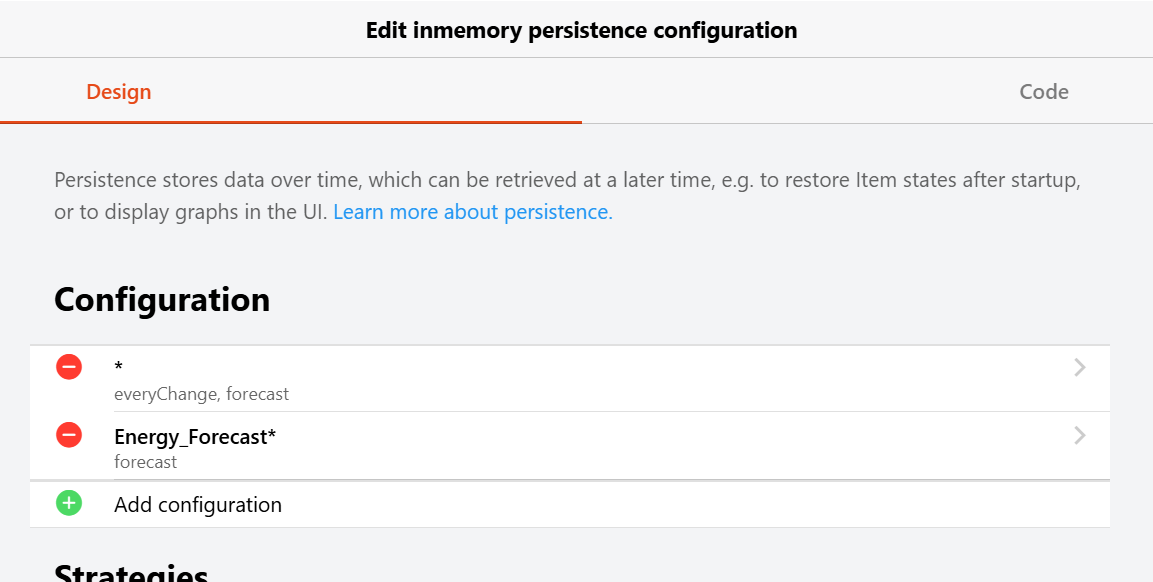

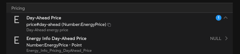

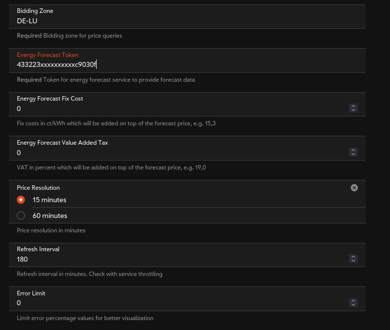

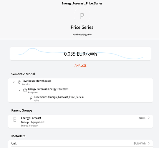

Ok, let’s see if we can figure out the problem:
Please provide me 2 screenshots similar to mine attached as example:
  • How does your item look like?
    In UI click Settings - Items, search your item and click on it.
    Result shall be similar to Pic 1)
  • How is your persistence configured?
    In UI click Settings - Persistence - Configure Persistence Policies - In Memory
    Result shall be similiar to Pic 2)
Pic 1
Pic 2
