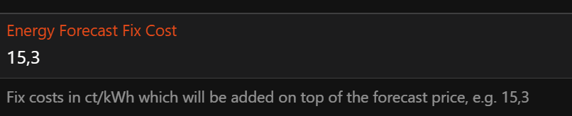

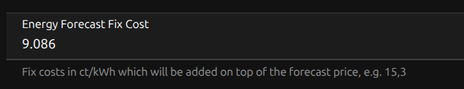

I see an issue and a typo here:
The issue is this offset is not applied on the DayAhead Price. It is applied on the Forecast Price. The typo is in the description text, the value needs to be entered with a dot, not a comma.

Ok, maybe i18n issue.My Regional Settings is Country Germany but Langauge is English so I can share screenshots in the forum. DOT isn’t accepted in these settings so I’ve to put COMMA.
Do you have other settings?

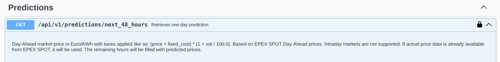

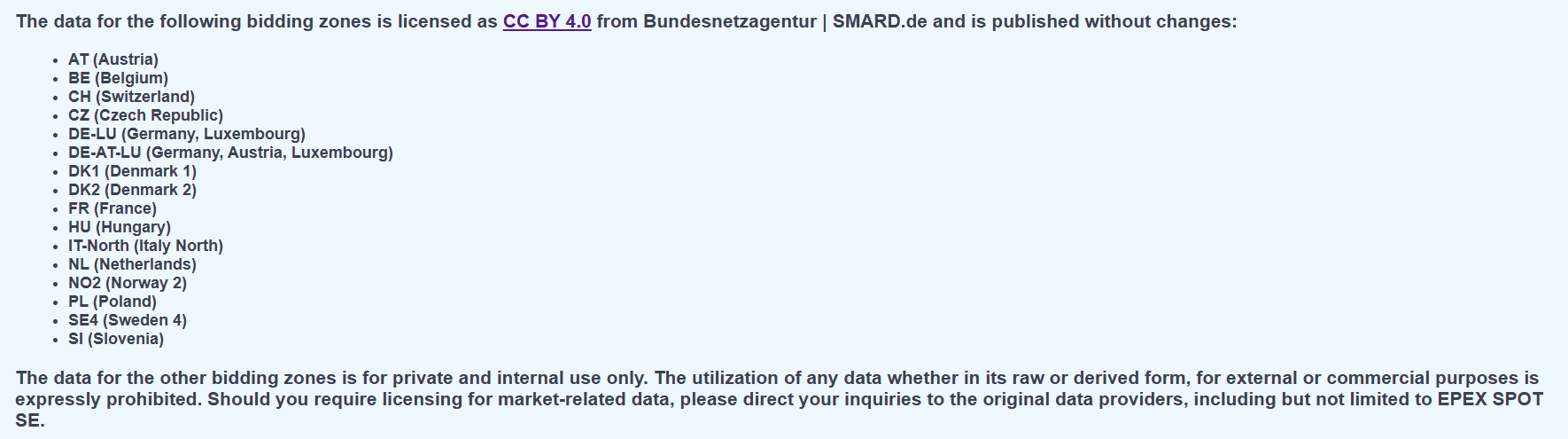

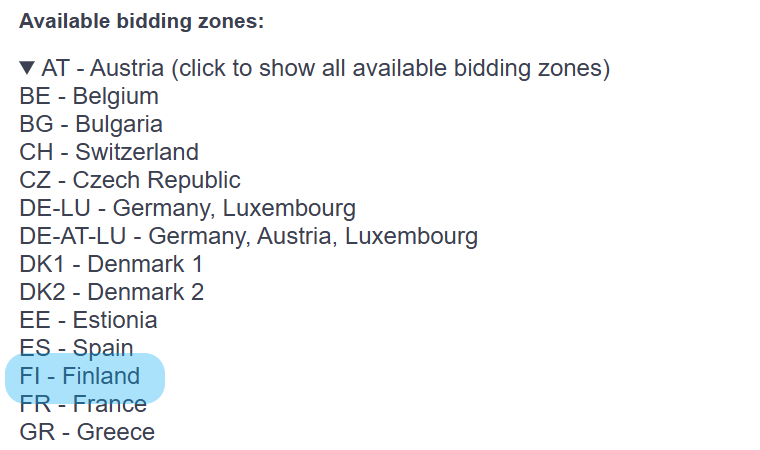

In fact they do (Pic 1)! But there’s a legal disclaimer which zones are licensed and which not (Pic 2). I hate these questions because I’m not a lawyer!
Let’s see - I removed now the restrictions to the options and you can enter FI into the Bidding zone configuration to receive prices for Finland.

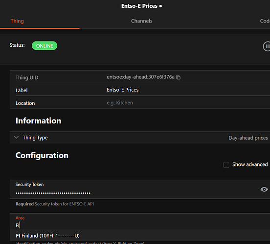

Nevertheless I want to highlight entsoe binding which is already providing energy prices for Finland (Pic 3).

@ weymann, many thanks for the info. I’m just wondering why the forecast data is not available in Finland. This would be very interesting feature. I’m already using entsoe binding but if the forecast data will become available in Finland then I’ll change to this new binding.
This is for sure the mentioned license issue.
EnergyForecast provides a commercial service, payment is needed for 96h forecast.
Creative Commons allows usage in commercial services. Seems only countries listed under CC4.0 are supported with a forecast.

thanks for the update of the .jar file. My Regional Settings is Country Deutschland and Language is Deutsch. Still, the Thing settings are in English so it accepts the dot only. I’m running OH 5.1.2 in Docker container. No idea where this is coming from :man_shrugging:

OK, thanks. I just wonder how to get Finland into the list in your Pic 2 above. It would be really interesting to get the forecast data because the electricity prices in Finland depend mainly on wind.

OK, thanks. I’ll contact Moritz and ask if he can add Finland.

@ weymann , I sent a message to Moritz and I got almost immediate response from him. His model doesn’t have the weather data yet for Finland but he is planning to add new data points some time in the future. Many thanks for your help.

I’m not sure what API you are using. I’m looking at the API documentation of the Energy Forecast service - here: API - Energyforecast
So that API provides 48h data. Isn’t that what you are pulling?
