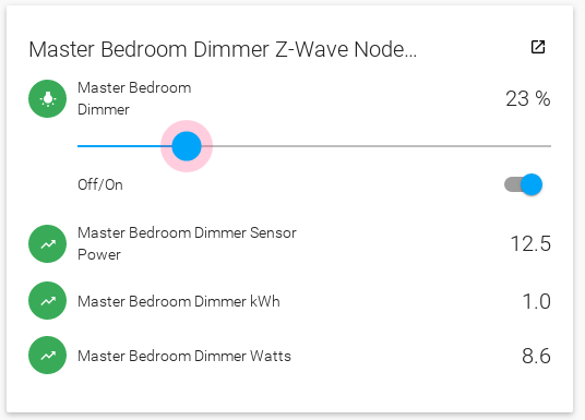

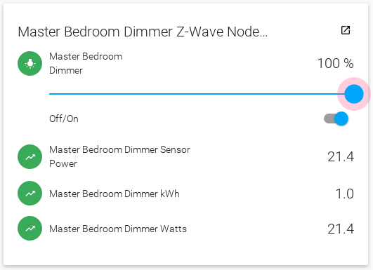

Just some extra info and a better understanding for me, below is my ZW500DM (non-Plus) with all 3 readings, but I’m not sure what Power is supposed to be as at 100% dimmer it says it’s using 21.4 Power and 21.4 Watts, but at 23% dimmer it is 12.5 Power and 8.6 Watts. I don’t think this could be power factor, so does anyone know what “Power” is supposed to be?
ZW500DM (Non-Plus Version)

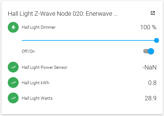

ZW20RM is reporting the numbers below, quite different from the dimmer, so hopefully someone can answer what the “Power” number is.
