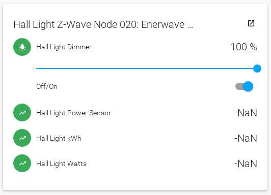

I have the below Enerwave switches, the first ZW500DM is fully working (switch/dimmer/power,kwh,watts), the other 2 are plus and are working for switching, but they don’t report the meter readings. I pasted the XML for the non-working ones below. I can’t compare the ZW500DM and ZW500DM-PLUS because I’m not sure what should be different from Plus to non-plus, or what makes the meters work. Does anyone know what I can do to troubleshoot this?
ZW500DM (1) - Working great, switch/dimmer, power, kwh, and watts reporting correctly.

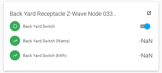

ZW500DM-PLUS (2) - Switch and Dimmer working, but power, kwh, and watts NOT reporting
ZW15SM-PLUS (1) - Switch working, but kwh and watts are NOT reporting, and Power isn’t even listed as a channel

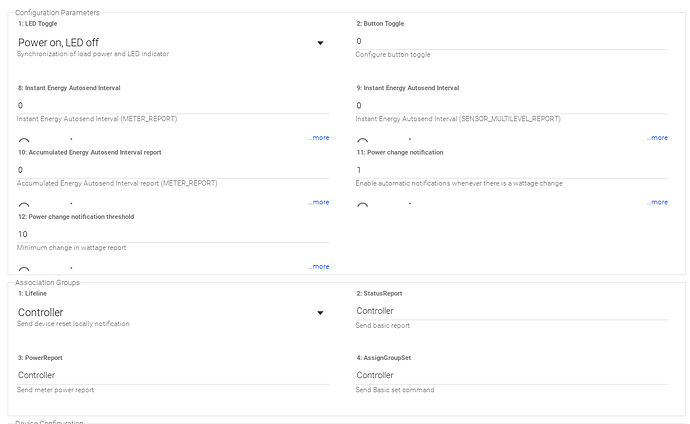

I think that is one of the things I tried, but I have reset it to controller on all 3 options, and will see if that makes a difference.
I’ve modified the post above with the right XML. I’m looking in the userdata/zwave folder for the devices XMLs. Can I manipulate the local database to test? The only thing I see that that is missing on the PLUS XML is the COMMAND_CLASS_SENSOR_MULTILEVEL, but that’s a guess, is this required for the sensors to work? If so, why would it be in the configuration for the ZW500DM and not the ZW500DM-PLUS when they both use the same database entry (both seem to be labeled ZW500DM).
After making the changes by assigning the Association Groups to the Controller, still not giving any meter readings. Also, you can see the second ZW15SM-PLUS doesn’t have a Power Sensor channel.
