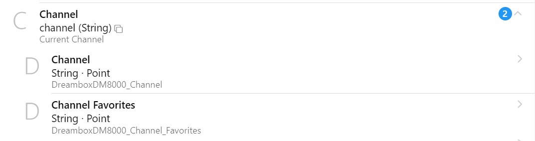

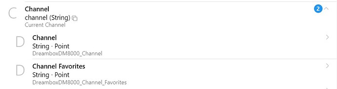

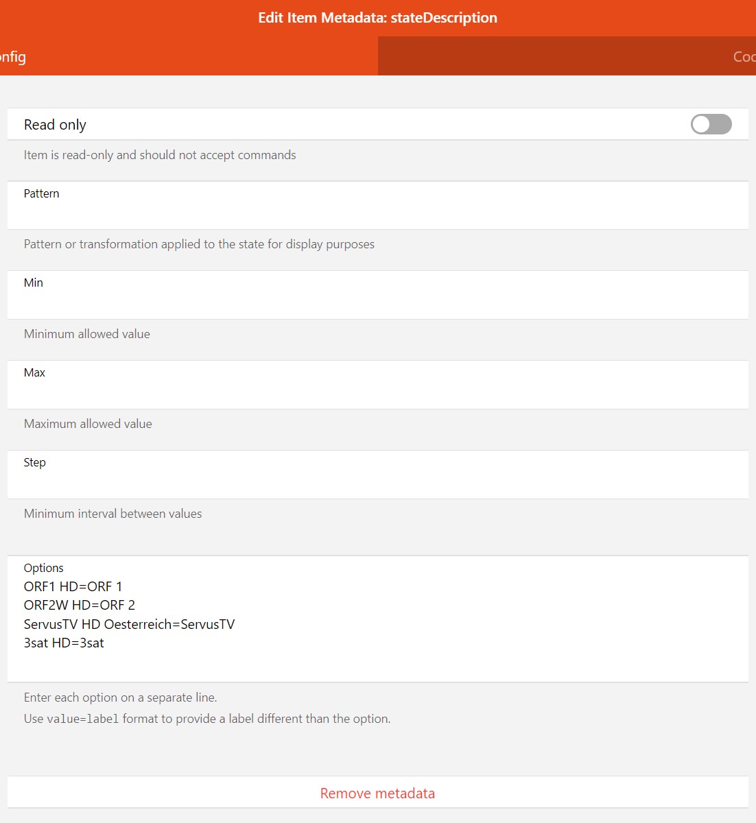

  • Set up 2 items for TV channels
  • 1st item for favorites
  • 2nd item for channel long list
  • link both items to:
Add the TV channel information to the item’s metadata (e.g. favorites):
That’s it.
