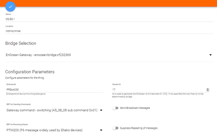

I have a similar issue: I don’t get any feedback from my FSR14:
Although I can switch all my lights using the binding and Openhab I unfortunately don’t get the status from the FSRs if the lights are switched from outside (wall switch).
Following config I’am using:
FAM14 (Pos. 5) ↔ USB ↔ RASPI4
Setting in Openhab Paper UI for the FSR14 (example):
The OG-E2-1 is linked to a switch
Any hint how to read the status of the FSRs and get the Openhab Switch updated?

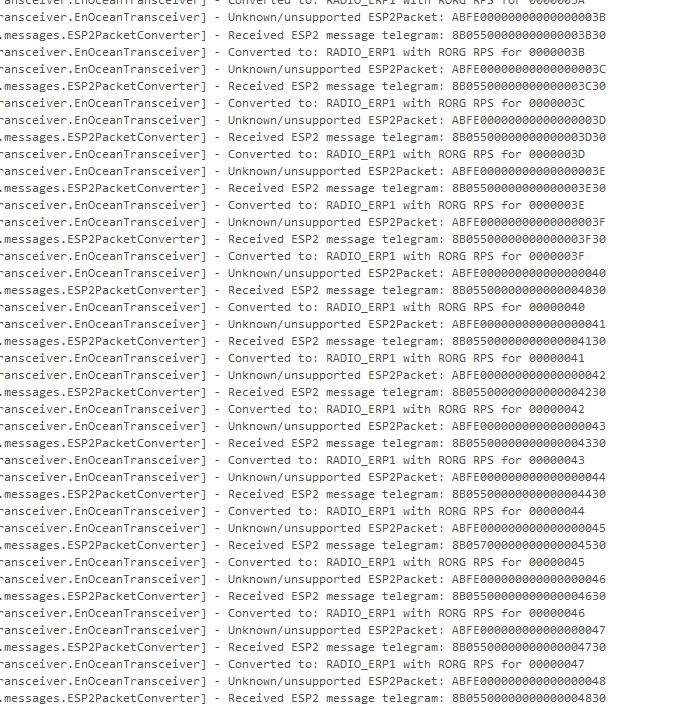

UPDATE
I change FAM Pos. 5 to Pos. 4 and now a long meassage list comes from FAM14, but still no update of the switch,
Try if position 2 on the FAM14 makes a difference.
