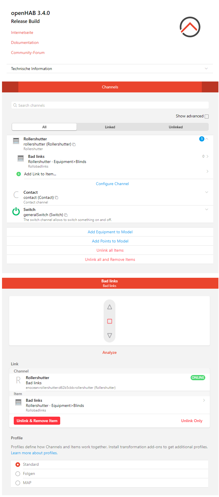

However, my dimmers and rollershutter are “switches” since then.
The “Thing” is still a “Rollershutter Actuator” and everything is configured as always. But under “Channels” the linked items now have a switch icon instead of a dimmer or up/stop/down buttons like before. The “Type” is still “Dimmer” or “Rollershutter”. But it still only shows the on/off switch like lights. Of course the dimmers and switches don’t work like this.

Rereading and trying to decode, it looks like more a UI “problem”. Is it when using MainUI?
It could be interesting to show us how is defined your utem.
What is the concerned channel?

I think you are right with your UI assumption!
I had restored my old openHAB 3.3.0 image a few days ago. When it was reloaded I had the same problem with the 3.3.0 version too! All shutters and dimmers were just switches.
At the same time it is not possible to open the menu item “Help & About” on the left side of the menu. Then only an empty page is displayed. On the openHAB app on the iPhone I had the same problem.
At some point it worked again on the website. But I don’t remember exactly what I did… “Help & About” also worked again.
On the iPhone app it then also worked again a day later after I deleted all possible caches in the app… After the 10th try, it sometime worked again on the iPhone app too.
