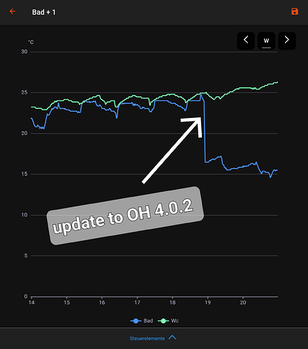

The readings are incorrect. Please see the drop in temperature and non changing humidity readings after updating from latest openocean version 3.2.0.0 to official Enocean binding 4.0.2.

@dirkdirk and whom also interessted in, I do also run EnOcean TF Sensors (EEP A5-04-03) and the values for temperatur and humidity have been correct over all OH3 versions and also with OH4 versions 4.0.1 (workaround) and now 4.0.2.
I use some enocean temperature sensors which are NOT EEP A5-10-12 (green line). They are working (A5-10-06) fine.
So it looks like (only?) the A5-10-12 (blue line) is not correct. Daniel (@fruggy83 ) fixed them some time ago.
