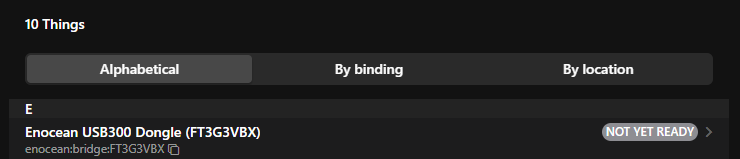

after a recent update, I noticed that my EnOcean USB300 Dongle stopped sending commands. The device was working perfectly before, but now it’s listed as “OFFLINE” with a “CONFIGURATION_ERROR: Port could not be found” message in the OpenHAB interface.

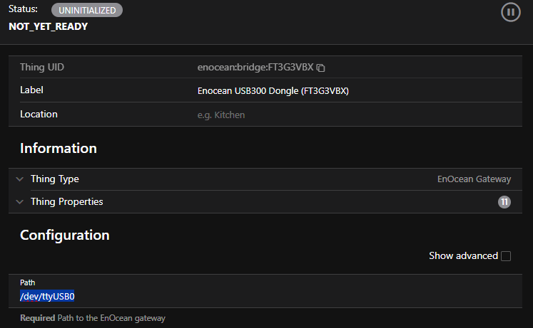

  2. Configuration Details:
    • Thing Configuration:
      UID: enocean:bridge:FT3G3VBX
      Label: Enocean USB300 Dongle (FT3G3VBX)
      Thing Type UID: enocean:bridge
      Configuration:
        - rs485BaseId: "00000000"
        - path: /dev/ttyUSB0
        - rs485: false
        - enableSmack: true
        - espVersion: ESP3
        - sendTeachOuts: false

It seems that my Think path was also reset after the update? I had entered the ID path here:
