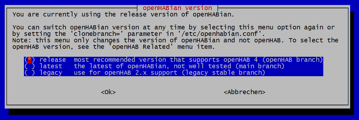

Hmm, ok, then something got screwed in openhabian, apt doesn’t offer the update:
openhabian@openhabian:~ $ sudo apt policy openhab
openhab:
  Installiert:           4.0.0-1
  Installationskandidat: 4.0.0-1
  Versionstabelle:
 *** 4.0.0-1 100
        100 /var/lib/dpkg/status
Not even the source repository is shown, making in look like it got installed manually.
Installation is defined on:
What repository do I need at “/etc/apt/…”?

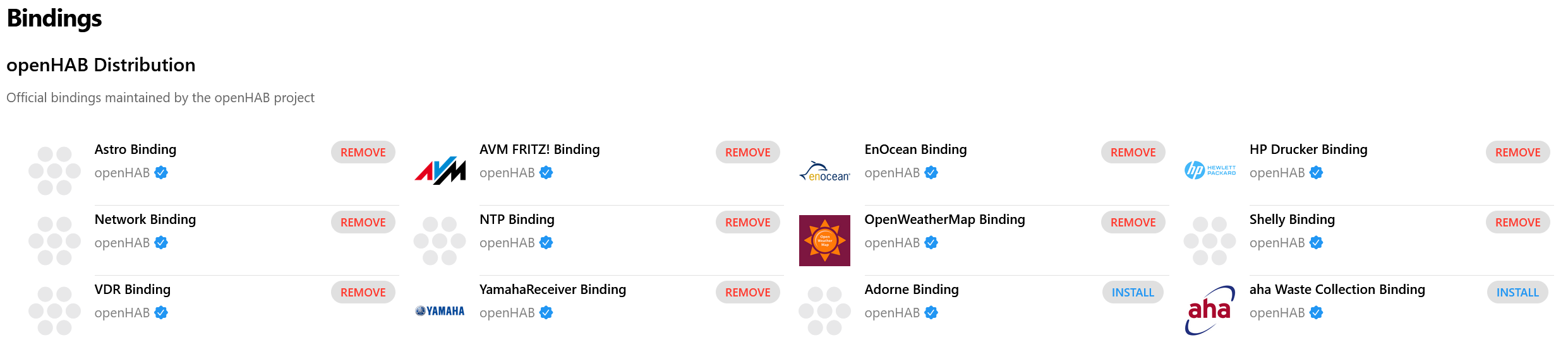

I never install bindings from MainUI or karaf console, I just maintain my bindings list in addon.cfg:
# A comma-separated list of bindings to install (e.g. "binding = knx,sonos,zwave")
#binding =
binding = astro,avmfritz,enocean,hpprinter,network,ntp,openweathermap,shelly,vdr,yamahareceiver
That way they are also shown as installed in MainUI:
