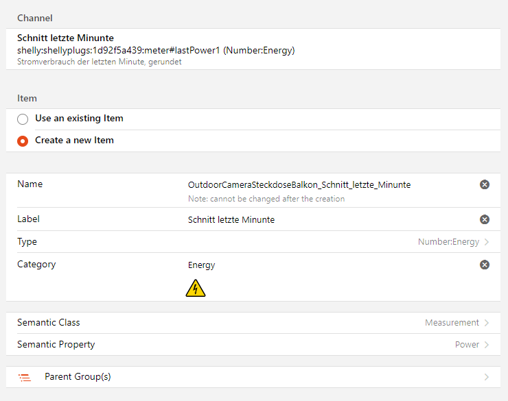

Shelly: Incompatible units
Symptom
Warnings logged: cannot convert from “W” to “kWh”
Mitigation
There’s a bug in binding, please wait for a fix. It can be tracked here:

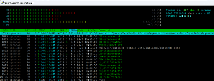

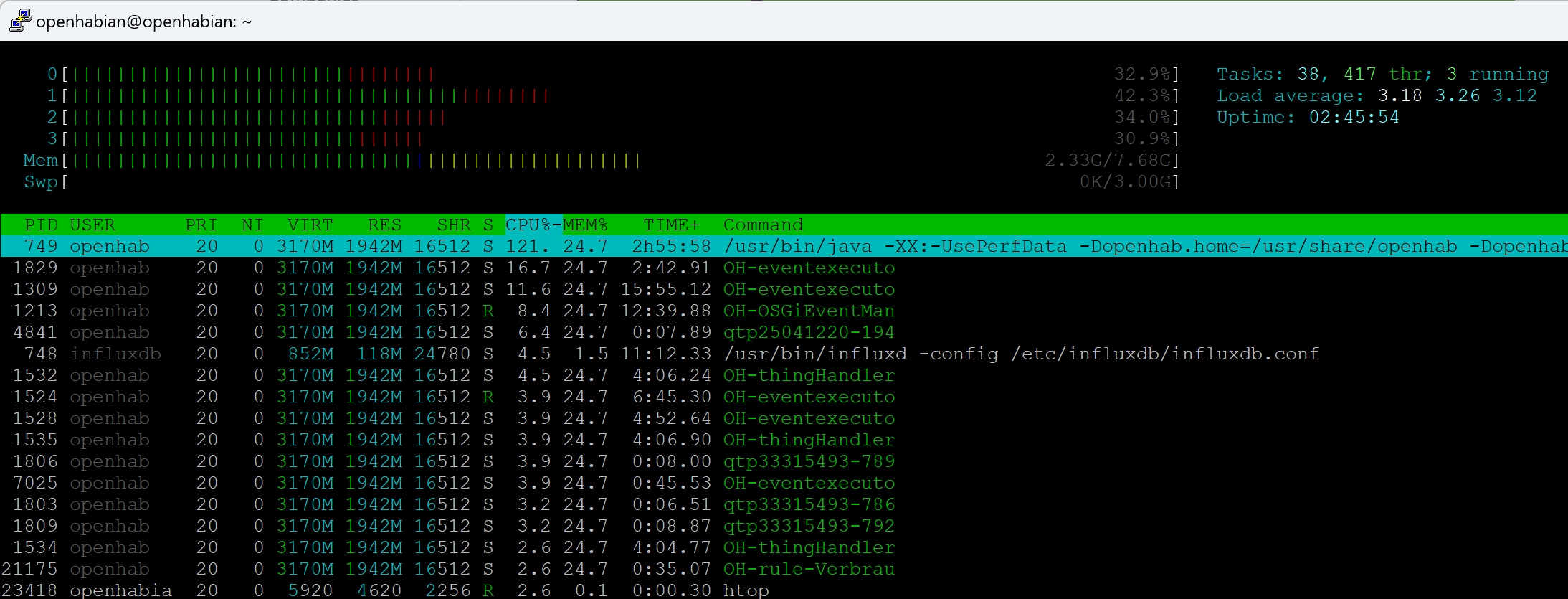

Restarts/sluggishness
Symptom
From time to time openHAB becomes slow and then ultimately restarts.
Mitigation
openHAB 4.0 and/or Java 17 seems to be using quite some more memory, and long-term openHABian users should adjust parameters as explained here:

Hi to All,
I’m also facing very high CPU loads. Before Upgrading to 4.0.1 I was running OH3.4.1 without any issues @ average CPU Load ~15-20%.
Running on, Raspberry PI 4, 8GB, Samsung 890 M.2 500GB
BTW: for OH4.0.1 I made a complete new Setup up on a new Harddrive, but I “configured” OH with a Backup.
Can you change the display option in htop to show the thread names?
That makes it easier to figure out what is causing the load.
See:
https://stackoverflow.com/a/21511530
I hope I made it as requested…
It could be event handling related based on those thread names.
There have been a few PRs regarding event handling which may have caused performance issues:
#3141, #3299, #3523, #3533, #3702
