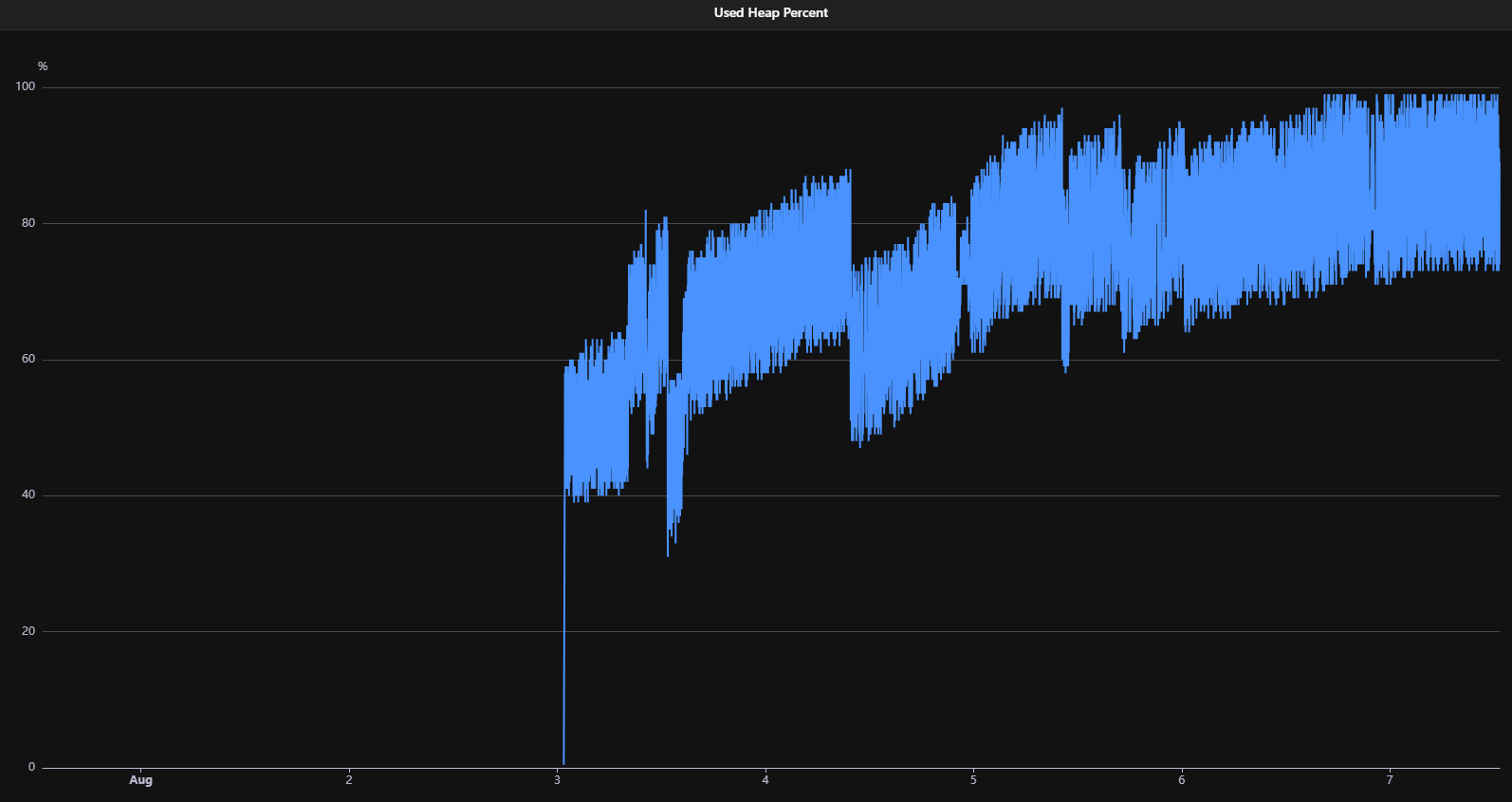

I also see that my Java Heap space is increasing, for now no errors in logs.
Since I’ve setup monitoring for Java heap space:
The memory of my P4 (4GB) is not getting higher than 40%.
