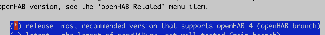

I just checked it on my dev system. I first changed this
which updated nicely to
I did not chose 02 but I then went to 41 (I did not run this but always cancelled it):
Note, I am on a snapshot build which is already beyond OH4 M3, so I do expect a downgrade warning, which I get but it says openHAB 2

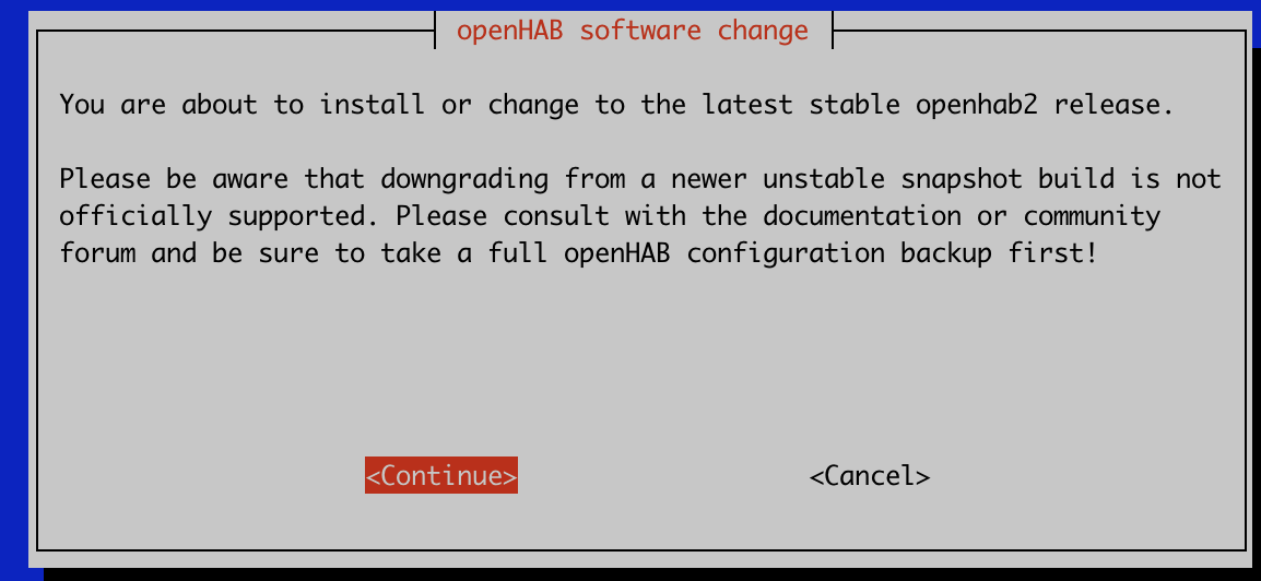

I did it anyway and it starts to download openHAB 2. Is this intended?
The same applies to Milestone which warns me to go back to OH2 milestone.

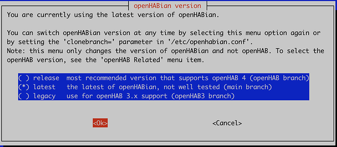

Then I went to 02 (having selected the release branch as mentioned above) and installs 4.0.0-SNAPSHOT (#3487)
The I chose latest and nothing changes (it comes back pretty quickly). So I presume release and latest are currently the same and this is the intended effect?
I hope that this is what you expected.

Well starting from a snapshot isn’t quite what I’m looking for in the first place, commonly users would not be on any snapshot but OH3. Well appreciated, though.
yes as the release package isn’t available, this option installs the milestone.
I somewhat doubt that is intended, its probably just a forgotten text update. I would fix it but I’m unable to, @mstormi can you look at it?
