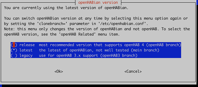

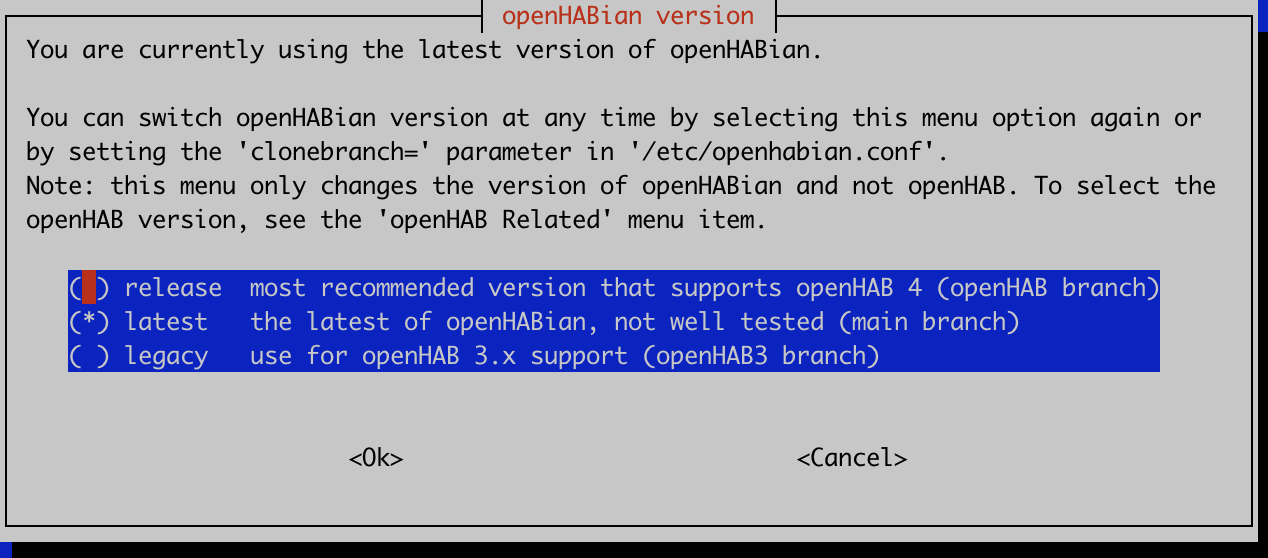

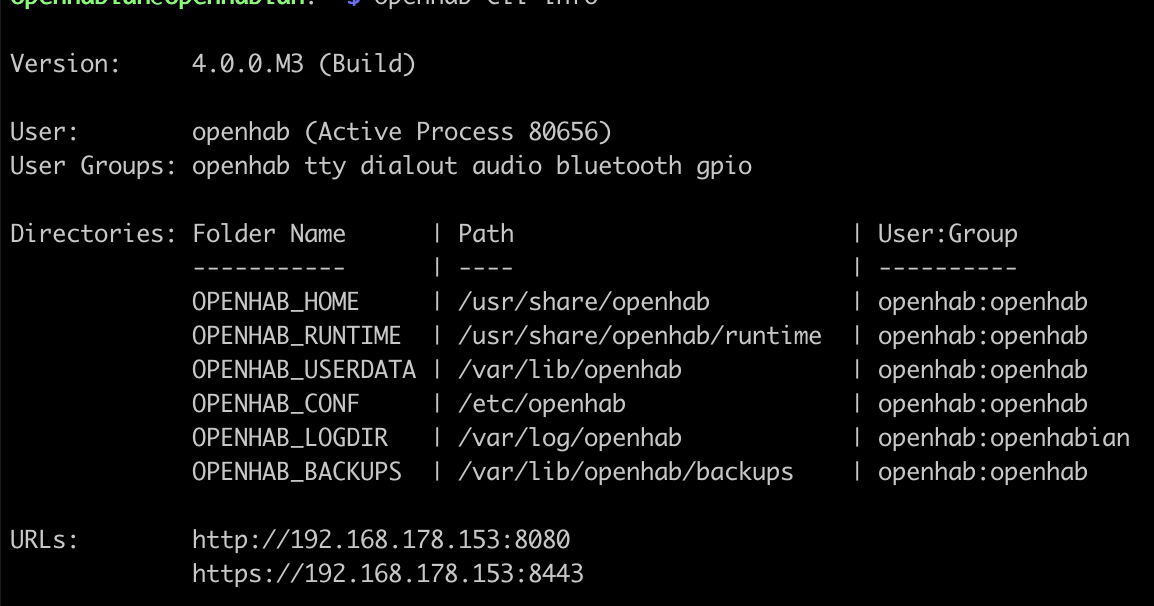

Branch: → Selected Main on 01
I am now on
which is weird compared to above because above I was on the 5th of June, now I am back on the 4th of June! :man_shrugging:
Selected 02 → just to be sure
and ONLY NOW it is retrieving 4.0.0 m3
Get:1 JFrog testing/main arm64 openhab all 4.0.0~M3-1 [103 MB]
and the result I am indeed on
Which I don’t understand why?!Maybe because the openhabian-config version has changed (see above)?

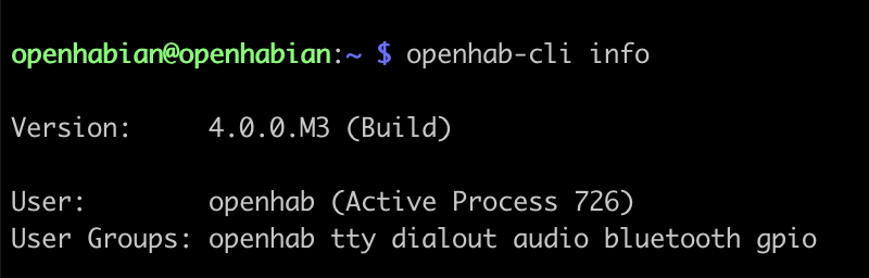

UPDATE:

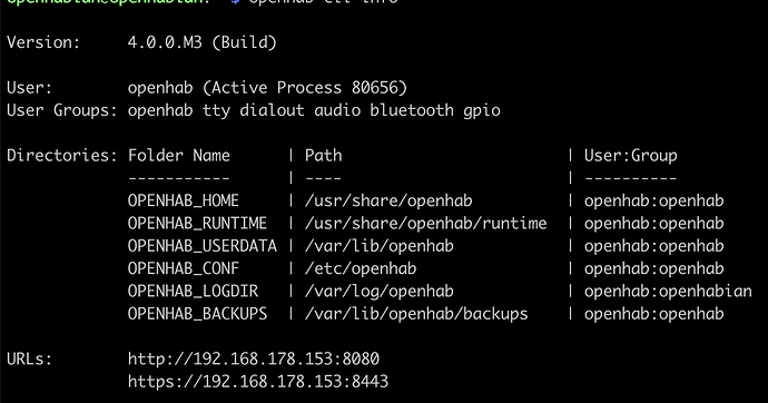

So, installed that version and it directly comes up with openHAB 4 M3

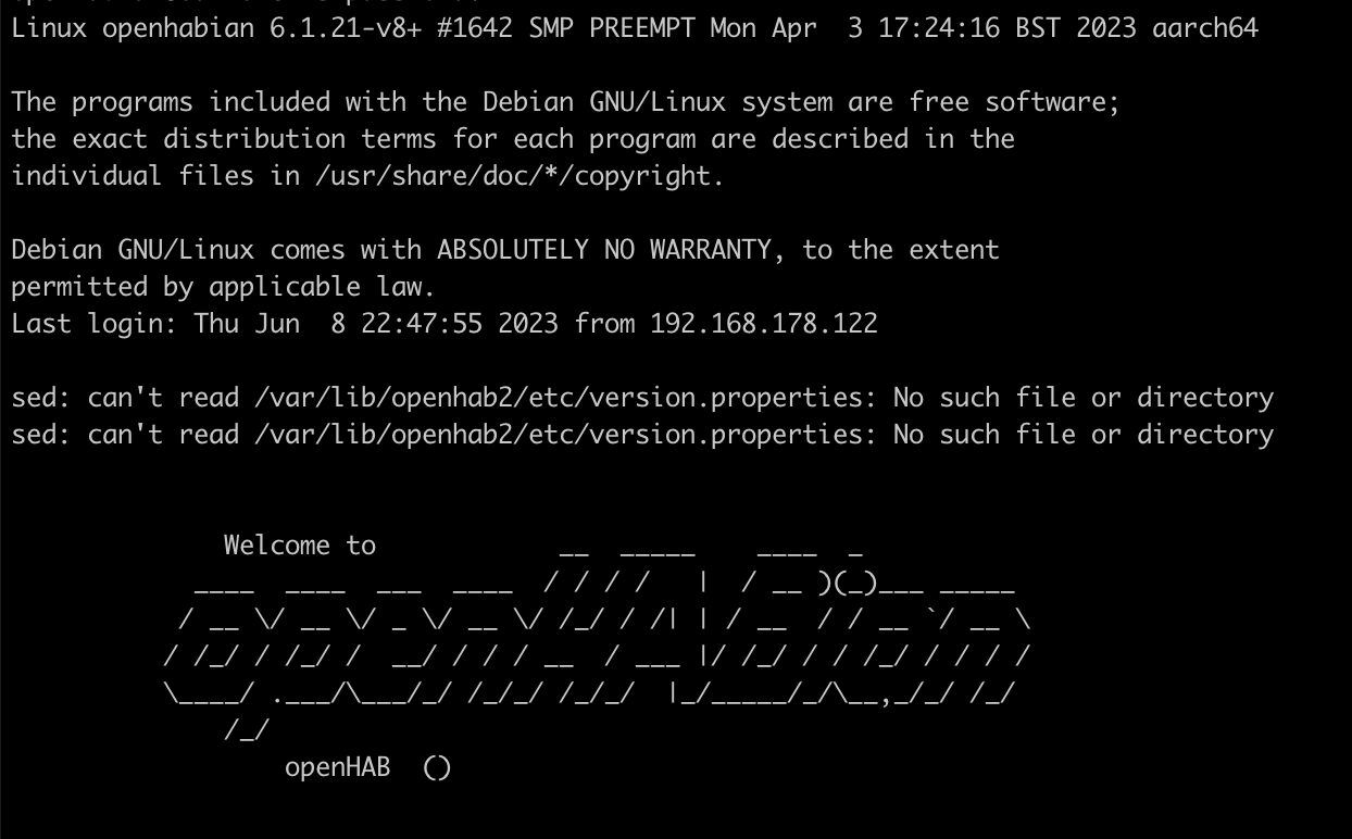

The only thing that isn’t completely right is the intro message, I guess:
openHAB () under the logo
and the fact that it wants to read something in openHAB2
sed: can’t read /var/lib/openhab2/etc/version.properties: No such file or directory

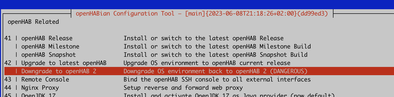

openhabian config says
openHABian Configuration Tool — [main]{2023-06-08T21:18:26+02:00}(dd99ed3)

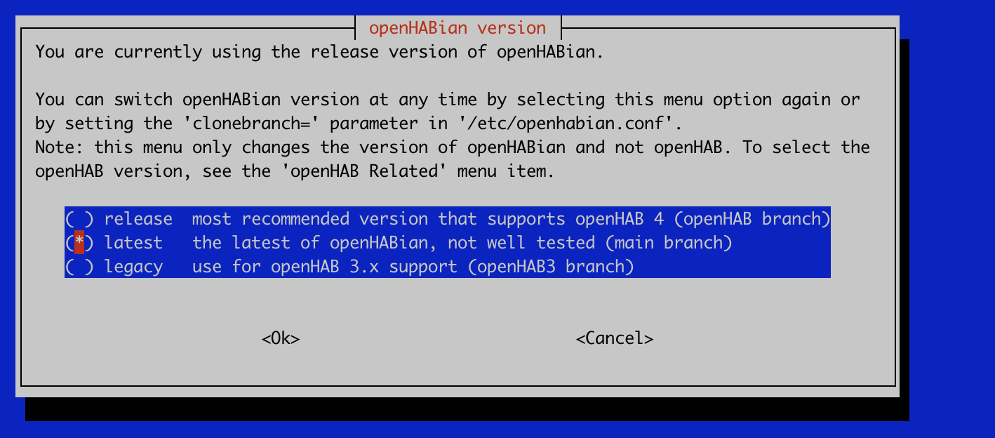

The branch is set to
I wonder if this setting still makes sense (downgrade to OH 2)

Greetings Markus,
I successfully installed OH4 using openhabian v1.8 -32 bit image on a RaspberryPI4 2GB
(openhabian-pi-raspios32-202306251506-gitb1e94d8-crc6a90b686.img.xz)
I am still running OH2 on my old rpi3b :smiley: but looking forward to migrating everything to OH4.
Cheers!
With an ‘empty’ OH config you mean ? Or did you manage to migrate yours ?
Well then you have to take care of all the potential issues in migration OH2->3 prior to (or in addition to) the migration from 3 to 4. As 2-> involves openHABian specific changes, if you want to keep your system I suggest you make it two migration steps.
Thank you. I decided to start 100% fresh and do things in accordance with latest guidance and set everything up from the start. Currently I have nothing :slight_smile: just working on getting the Airquality binding working and then i will start with some of the rest.
I just want to gain some familiarity and running on SD card for now, but want to run on SSD like my other setup, so I don’t want to get too far along until I clean up my architecture.
