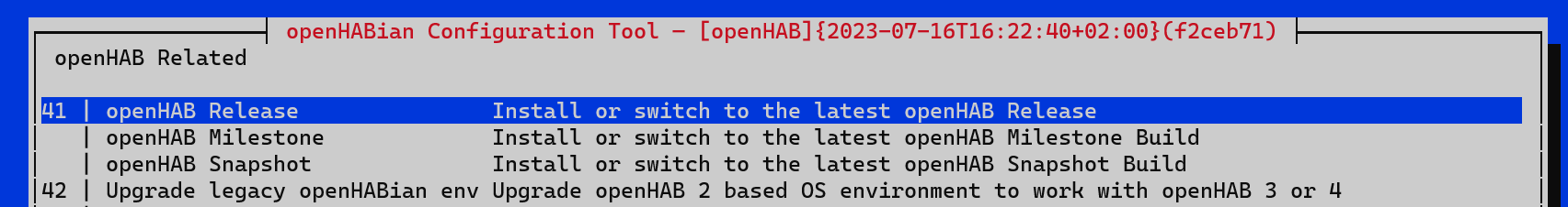

If I choose 41 openhab Release today:
What will be installed?
Openhab 3.4.4 Stable or Openhab 4.0.0 M5?
If I choose openhab Release tomorrow will than bei Openhab 4.0.0 RC1 installed?
Thank you in advance…
latest OH4 milestone will be installed.
Thank you
Ah no if you go that way via menu it’s probably release so still 3.4.4
Enable debugging and see for yourself
I can confirm that
  • the release branch will install 3.4.4-2
  • the openHAB Milestone build will install 4.0.0~RC1-1
Unfortunately install openJDK 17 via 45.

Just a short note. If you use openhabian-config point 41 to switch to the latest version, which is now 4.0, it still says „ OH3 installing“.
