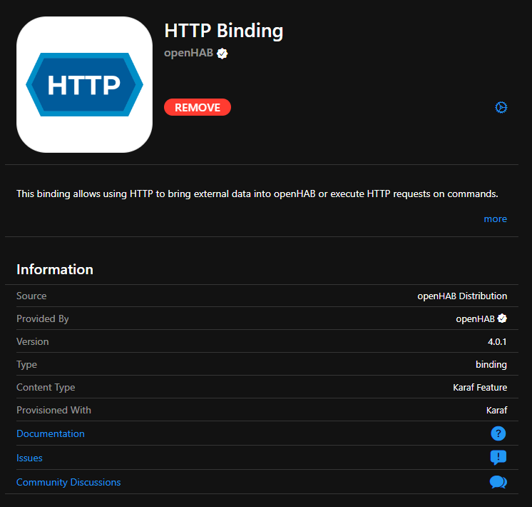

  1. Can someone install the HTTP Binding (it takes one click to install in web ui), and test the simplest thing definition I’ve been able to repro the issue with:
Thing http:url:test "Test" [ baseURL="#" ]
