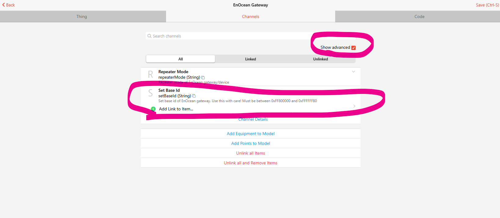

hey, could you advise how to change BaseID for my USB300 stick
there is a „Set Base Id“ channel unter the advanced options for your gateway thing.
With this channel you can write the new base id onto the stick.
But use it with caution, you can do this only 10 times.

Hmm, I set it there under “Use following BaseId when connected directly to RS485 BUS” but can’t see it was changed when checking in DolphinView :thinking:
No this is not correct. you don’t connect directly to RS485 BUS via a cable. You connect wireless via the USB300 stick. The base ID needs to be written onto the stick.
Check this link:
thank you! I managed to change it now :slight_smile:
