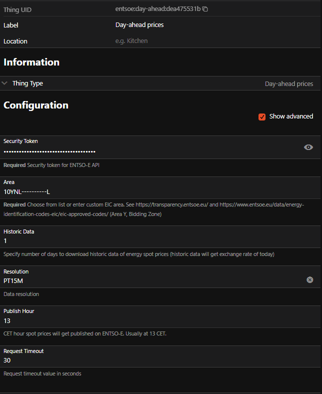

These are the settings for the Thing:
Does anyone have any idea where I am going wrong?
Your issue is likely due to persistence changes in 5.1, see the big thread on that for details.
In short: if you have an inmemory.persist remove the default strategy entry there.
@mstormi , thanks for the tip. I just checked my setup and I don’t have inmemory persistence installed, but do have JDBC persistence. I had already figured out that I needed to remove the default strategy from the JDBC persistence configuration, but I have just double checked it is actually the case. All other data is updating and logging fine. It is just the electricity prices that appear stuck at a fixed historic value.
For the EntsoE binding in 5.0+ the EnergyPrice item is a TimeSeries.
These you need to persist with inmemory (in addition to whatever default persistence you’re using).
@mstormi Thanks for that tip. I’ve added the inmemory persistence and it has correctly updated since.
