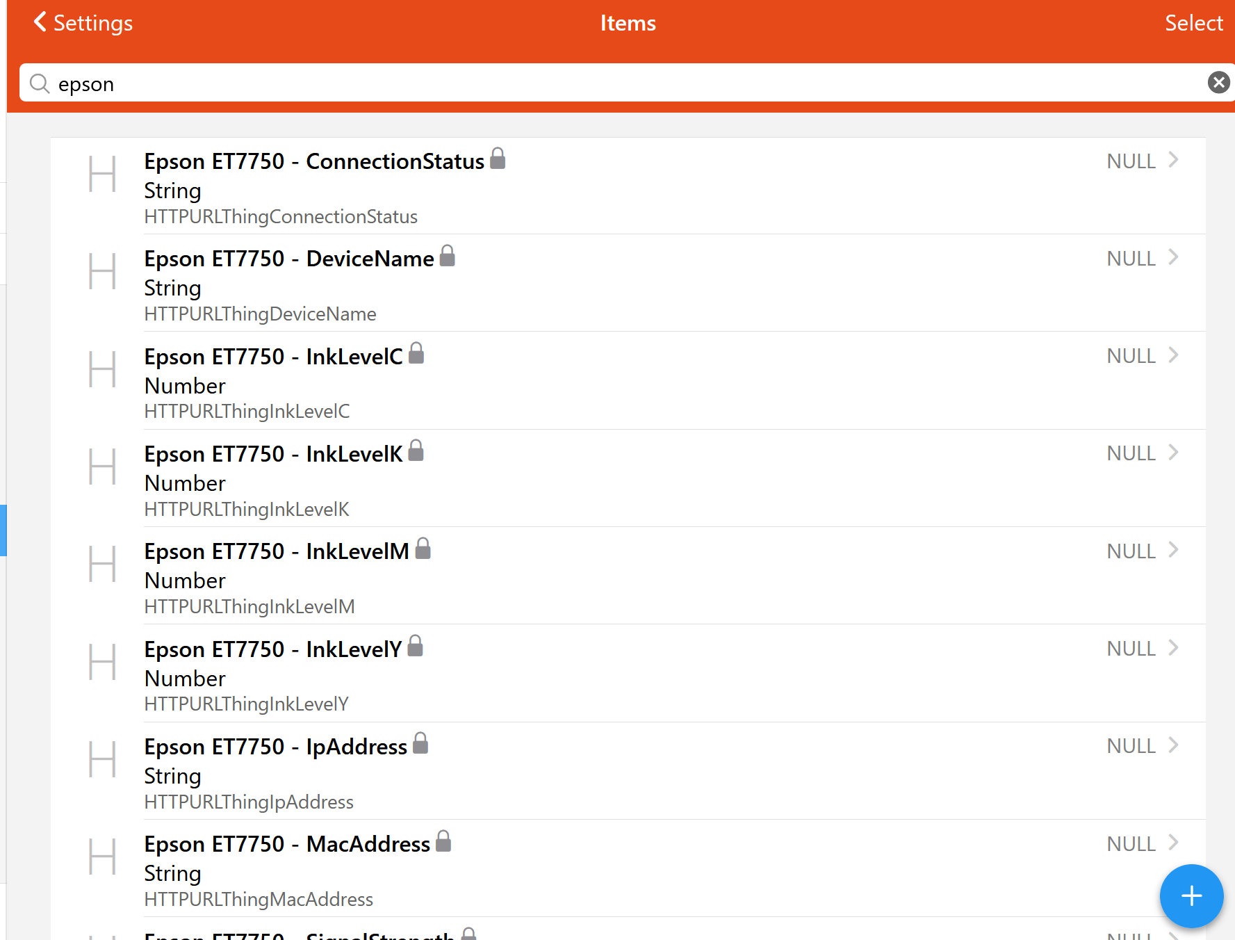

epson.items
String   Epson352Status           "Status [%s]"              <status>   {channel="http:url:epson352:status", expire="301s,state=Offline"}
Number   Epson352InkLevelC        "Cyan Ink Level [%.0f/50]"    <rgb>   {channel="http:url:epson352:inkLevelC"}
Number   Epson352InkLevelM        "Magenta Ink Level [%.0f/50]" <rgb>   {channel="http:url:epson352:inkLevelM"}
Number   Epson352InkLevelY        "Yellow Ink Level [%.0f/50]"  <rgb>   {channel="http:url:epson352:inkLevelY"}
Number   Epson352InkLevelK        "Black Ink Level [%.0f/50]"   <rgb>   {channel="http:url:epson352:inkLevelK"}
String   Epson352DeviceName       "Device name [%s]"         <keyring>  {channel="http:url:epson352:deviceName"}
String   Epson352ConnectionStatus "Connection status [%s]"   <network>  {channel="http:url:epson352:connectionStatus", expire="301s,state=Offline"}
String   Epson352SignalStrength   "Signal Strength [%s]" <qualityofservice> {channel="http:url:epson352:signalStrength", expire="301s,state=Offline"}
String   Epson352IpAddress       "IP address [%s]"         <network>  {channel="http:url:epson352:ipAddress"}
String   Epson352MacAddress       "MAC address [%s]"         <network>  {channel="http:url:epson352:macAddress"}
DateTime Epson352LastUpdated "Last updated [%1$td/%1$tm/%1$ty %1$tH:%1$tM]" <time> {channel="http:url:epson352:status" [profile="timestamp-update"] }

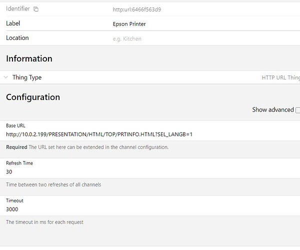

I am new to the forum, but have read quite a lot so far. I am from Germany and still quite new and inexperienced with Openhab.
About my problem. I have an Epson Ecotank printer and want to read out the basic durucker data via Openhab. I use the following configuration:
  • Openhab 3.4.4 via Docker on Qnap NAS.
  • Bindings HTTP as well as javascript transformation as well as others are installed.
The printer status page is accessible via the browser, the source code is as described in Ronny’s post. I created the Things and JS files as described in Ronny’s post and created corresponding Items. In Openhab, the Things and Items are also displayed as online, but there are no values for all, only ‘NULL’ is output.
The source code from the browser:

My Epson_Printer.things file:
Thing http:url:epson [
        baseURL="192.168.178.44/PRESENTATION/HTML/TOP/PRTINFO.HTML?SEL_LANGB=1",
        refresh=60,
        commandMethod="GET" ]

My Items for the colors and printer name
Number   HTTPURLThingInkLevelC       "Epson ET7750 - Füllstand Cyan"            {channel="http:url:epson:inkLevelC"}
Number   HTTPURLThingInkLevelM       "Epson ET7750 - Füllstand Magenta"         {channel="http:url:epson:inkLevelM"}
Number   HTTPURLThingInkLevelY       "Epson ET7750 - Füllstand Gelb"            {channel="http:url:epson:inkLevelY"}
Number   HTTPURLThingInkLevelBK      "Epson ET7750 - Füllstand Schwarz"         {channel="http:url:epson:inkLevelBK"}
Number   HTTPURLThingInkLevelPBK     "Epson ET7750 - Füllstand Foto-Schwarz"    {channel="http:url:epson:inkLevelPBK"}
Number   HTTPURLThingInkLevelWaste   "Epson ET7750 - Waste Tank "               {channel="http:url:epson:inkLevelWaste"}
String   HTTPURLThingDeviceName      "Epson ET7750 - Druckername"               {channel="http:url:epson:deviceName"}
My things and items in Openhab:
Does anyone have an idea what the error could be. I’ve been trying for days to get this to work, unfortunately without success.
Many thanks and greetings
Hoasi

here is a short update on the topic.
After a long time of trying, I finally managed to read the printer data. The problem was that I tried to retrieve the data via a secure connection. But since it was an unsecured connection, that didn’t work. After I put a ‘http://xxx.xxx.xxx.xxx…’ in front of the address it worked.
        baseURL="http://xxx.xxx.xxx.xxx/PRESENTATION/HTML/TOP/PRTINFO.HTML?SEL_LANGB=1",
        refresh=60,
Maybe it helps one or the other who has the same problem.
