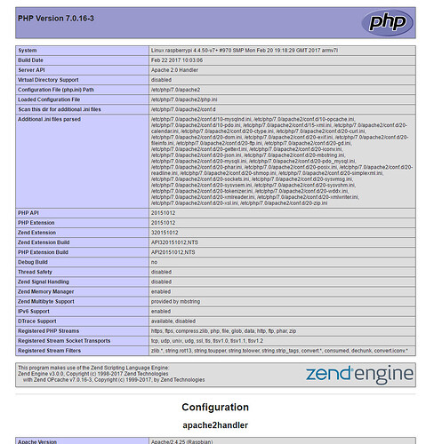

  1. install php, i did this with the following code fence:
sudo apt-get -t stretch -y install php7.0 php7.0-mysql php7.0-curl php7.0-gd php7.0-zip php7.0-fpm php7.0-cli php7.0-opcache php7.0-json php7.0-mbstring php7.0-xml libapache2-mod-php7.0
  1. create the following file via
sudo nano /var/www/html/info.php
and add the following code
<?php
phpinfo();
  1. go to your rpi webser again with the following link, e.g.
http://raspberrypi/info.php
  1. check if everything is working:
At the end, for me the above mentioned code fence remains, after having set up the php webserver, in a completely empty, blank, webpage, and nothing did change to the radiator.
