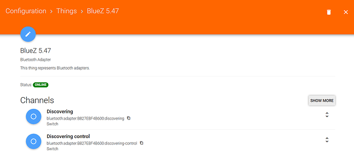

I received the radiator and plugged it onto my heating. I installed the bluetooth binding via the eclipse market place, and after some tayloring of the bluez libraries, the bluetooth adapter item was found via paper ui.
Now, i can see alot of new bluetooth devices, e.g. my phone, some tvs, etc. Also, the bluetooth radiator valve was found via the inbox paper ui. heres what i have at the moment:
BlueZ Adapter is working:

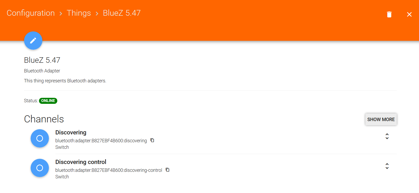

Then i added the radiator bluetooth valve as a thing via the inbox menu; this is what is see in the thing menu:
BUT:
i cannot control the radiator valve nor see any data (room temp, etc.).
Any ideas?
This is what I meant by saying “I’ll be happy to help”. It is not implemented yet.
