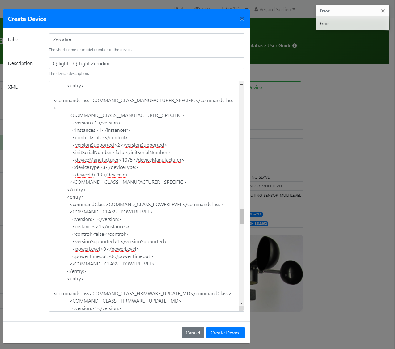

Trying to add a new z-wave device into the database (https://opensmarthouse.org/) for the z-wave binding for openHAB, but are only getting error when trying to add.
I am using the xml file generated by the zwave binding, but i think maby it is not complete or have errors. I have allso tried exluding and including several times, but the xml file looks the same.
The file should be fine (as it was produced by the binding), and it is complete as far as I see it. Can you tell us the error you get when you try to upload the file?
The only information about the error is the error message I get when I try to push the button “Create Device” and a error appear in the corner, as in the picture in the first post.
I assume you followed the database guide and raised a ticket to get your access rights updated? Missing rights is the most likely candidate for the error in absence of a real error message that could be interpreted. I suggest to ask @chris
