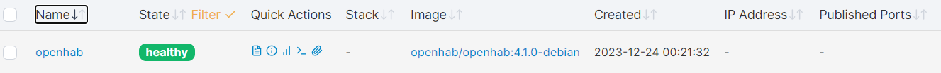

I have moved my Openhab instance from a Raspberry to a Docker. Now I have problems connecting the MQTT broker.
Setup
[oldOpenhab] (Raspberry) Config: Openhabian, zigbee2mqtt, eclipse-mosquitto
[newOpenhab] (Ubuntu Server with Docker) Config: Docker, Container: Openhab)
Error MQTT Binding
COMMUNICATION_ERROR
io.netty.channel.AbstractChannel$AnnotatedConnectException: Connection refused: /:1883
