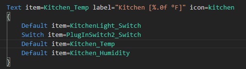

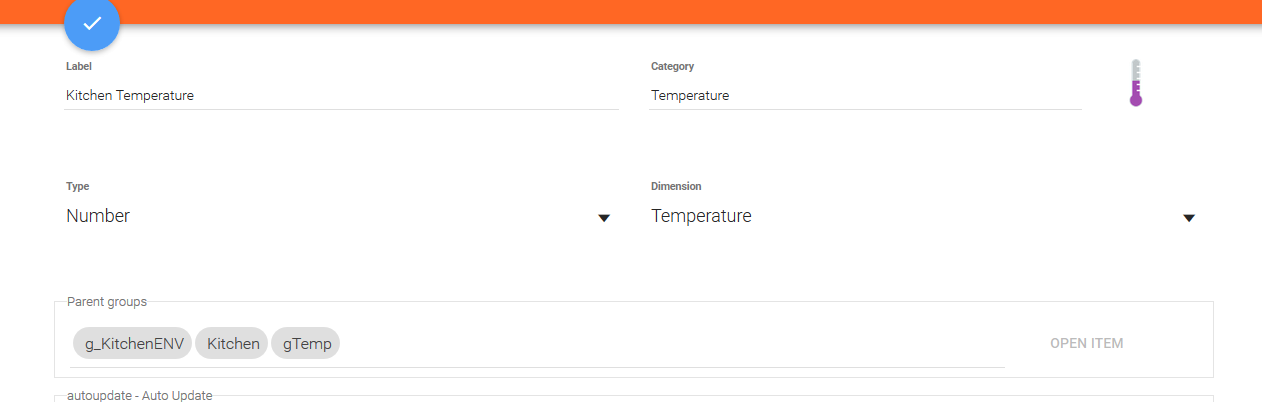

Item info that is not working in sitemap:
Note: If I add “label” to the item and force the type, it works fine.

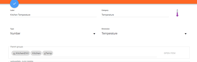

Working Item info with no issues:
Thanks!
