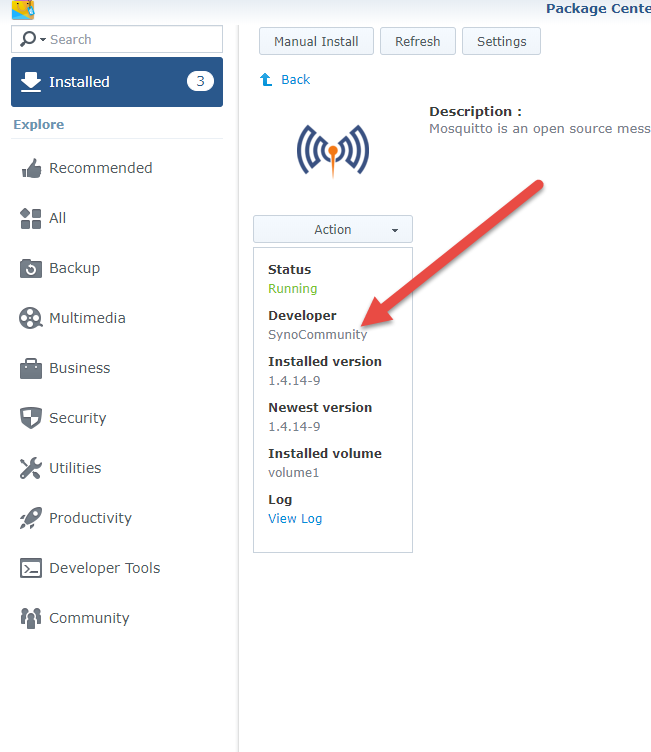

you have to install the mosquitto package
edsel
(Harry Kas)
March 13, 2018, 1:45pm
10
I try to find out which package can be used for Synology Diskstation.
binderth
(Thomas Binder)
March 13, 2018, 2:06pm
13
As you answered above: If you donât know, which broker you use - it wonât work. The MQTT-binding only installs the binding , nothing else. Try to think of it like this: the KNX binding also wonât install KNX for you, would it?
So, with this in mind - the http binding wonât install some kind of http-Server - you can install the mosquitto package natively on you synology (I use it also - youâre lucky: as of the last version you just need the package and wonât Need to adjust the configuraiton via SSH - there was a bug fixed lately to add mosquitto-users).
Long Story short:
Install the package and it will give you a MQTT broker without credentials. You just need to configure the IP in mqtt.cfg and youâre good to go. on the other hand, be sure to leave the credentials blank in your Sonoffsâ configuration also.
edsel
