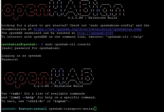

In console openhab> feature:install openhab-transport-serial
This is added automatically when you install the binding from UI, but if you drop a .jar in addons, you need to add it.

Since it says logging in as openhab and that’s not my username I tried to switch users with “su - openhab” and then “habopen” for the password, per the console documentation, but it returns with “Authentication failure”
From my picture: Password for openhabian is my personal system. The openhab password is simply habopen. Don’t try to switch users, just go with habopen.
