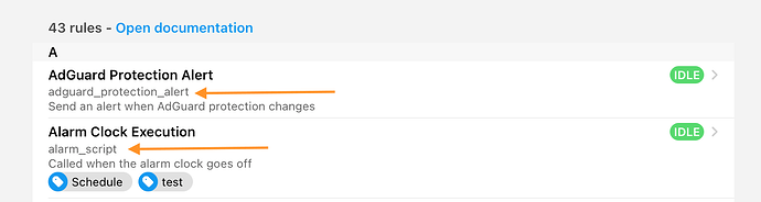

That’s why I strongly recommend that all rules define their UID instead of depending on the random ones that are generated when you don’t define the UID.
If you think this is a rule (the most likely culpret) navigate to Settings → Rules and search for that UID. If you don’t find it there, repeat in Settings → Scripts. Alternatively, open the developer sidebar (alt-shift-d) and search for the UID there. Alternatively you can search through `$OH_USERDATA/jsondb/automation_rules.json. Alternatively you can use the REST API Docs (under developer tools) to bring up that rule from the rules endpoint.

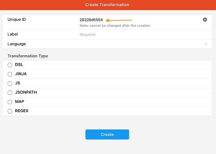

It’s not likely to be a transformation as transformations don’t have UIDs that look like that (if created through the UI the ID is much shorter, if created in a file the filename is the UID).

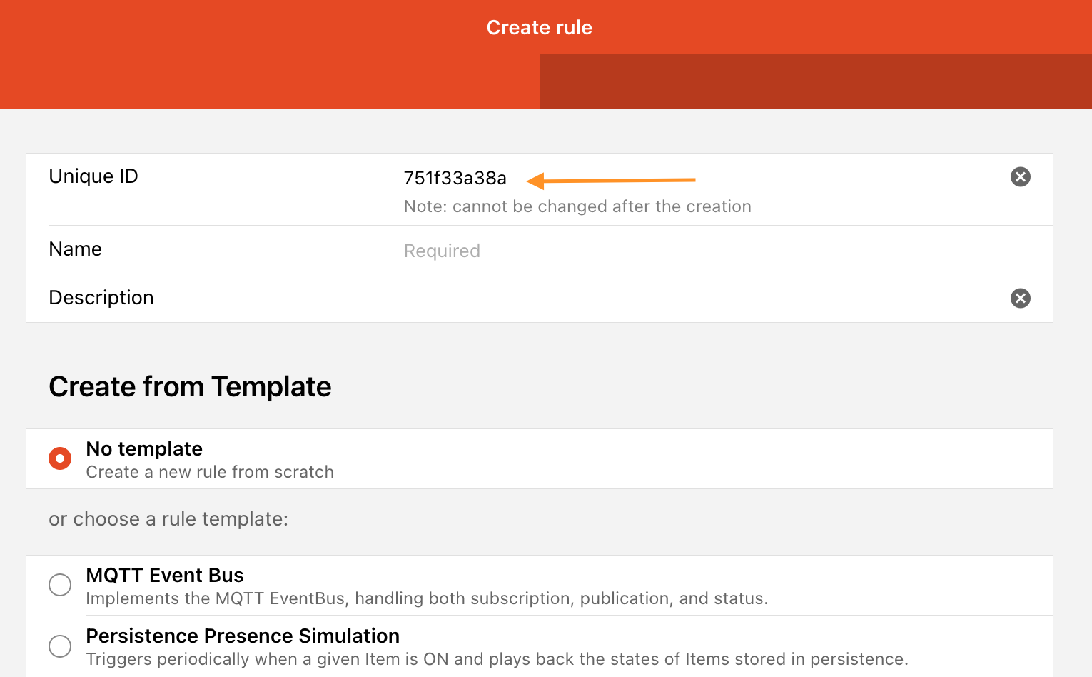

When you create the rule:
When you create a transformation through the UI:
In .rules files the UID becomes the name of the file with -N appended where N is the rule’s position inside the file (e.g. the third rule in a file named lights.rules would be lights-3).
For the other rules languages, there is usually an option to set the ID when creating the rule. If you do not you get a randomly generated UID.
As then screen shots indicate, you cannot change it once the rule is created. Therefore once the rule is created there’s no option to change it. But the Rule’s UID is shown on the Rules page and it can be searched.

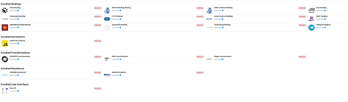

for each of my scripts. And if I look into my add-ons I can see JavaScript Scripting is installed:
it seems like the rules are activated and working fine afterwards. It is just a bit confusing that during startup the ERROR messages occur…
Are you clearing the cache before starting OH when you see these errors?
Those words mean the JS Scripting add-on isn’t ready when the rules engine starts. And since the add-on isn’t ready, OH cheating can’t do anything with the rules that need that add-on to run.
These are old rules (OH 3.x). While not errors or even warnings, it would be a good idea to edit these Scripts to use just “application/javascript” as the type.
