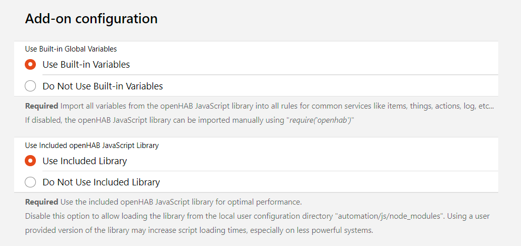

One good thing to try is to make sure you are running with the latest of both libraries to see if the problem persists. If you are using an older version of the helper library installed through npm you can change the settings of the JS Scripting addon to use the built in version instead as that one should be relatively recent (4.2.0 I think for M3).

from the /conf/automation/js/node_modules/openhab_rules_tools folder. It looked like something was successful, but I still get the same error when checking the OHRT version.
npm is such a pain sometimes. The latest version is 2.0.2 of OHRT. But npm won’t automatically upgrade major version numbers like that.
It might work to change the version number in package.json to “^2.0.2” and then run the upgrade. If that doesn’t work, use npm uninstall openhab_rules_tools, double check that the line is removed from package.json, then reinstall.
That last bit should also tell you how to remove openhab-js.
