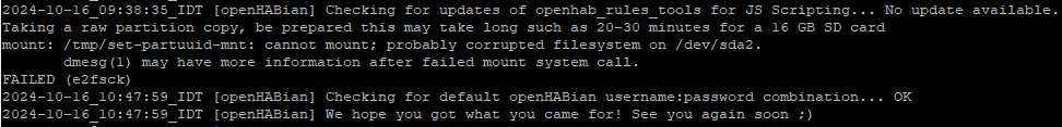

I am trying to set up SD card mirroring again on my Pi5. I am using a 64GB San Disk High Endurance, the internal SD card is a 32GB San Disk Max Endurance.
Whenever I try to setup SD Card Mirroring via openhabian-config I get the following error message:
2024-08-29_14:48:24_CEST [openHABian] Setting up automated SD mirroring and backup... Checking that no-one is using this disk right now ... OK

Taking a raw partition copy, be prepared this may take long such as 20-30 minutes for a 16 GB SD card
mount: /tmp/set-partuuid-mnt: cannot mount; probably corrupted filesystem on /dev/sda2.
       dmesg(1) may have more information after failed mount system call.
FAILED (e2fsck)
OK
The SD card is brand new, I also checked for bad sectors. How can I figure out what’s going on and fix this issue so I finally have a backup running again?

Exactly the same for me, also with a brand new MicroSD on a Pi5.
openhabian 6.6.31+rpt-rpi-2712 / openHAB 4.2.2 - Release Build
Any help is highly appreciated.
Edit: trying to raw copy from a 16 GB to a 16 GB card.
I had the same error
What i did was put the SD card in Windows PC and delete all partitions from the SD and after that run the SD RAW copy from OpenHab
Hello, I also have the same error when trying to copy a 32GB SD card.
In another post someone tried using the SD card even though it gave an error and it worked for that person. I also tried this with my copied SD card but the pi didn’t boot. So for me it didn’t work. Hopefully this can be fixed asap.

++ blkid /dev/mmcblk0p2
++ sed -n 's|^.*PARTUUID="\(\S\+\)".*|\1|p'
++ sed -e s/-02//g
+ origPartUUID=e1241585
++ yes
++ set-partuuid /dev/sda2 random
++ awk '/^PARTUUID/ { print substr($7,1,length($7) - 3) }'
+ partUUID=
+ cond_redirect e2fsck -f -y /dev/sda2

+ return 1
+ echo 'FAILED (e2fsck)'
FAILED (e2fsck)
