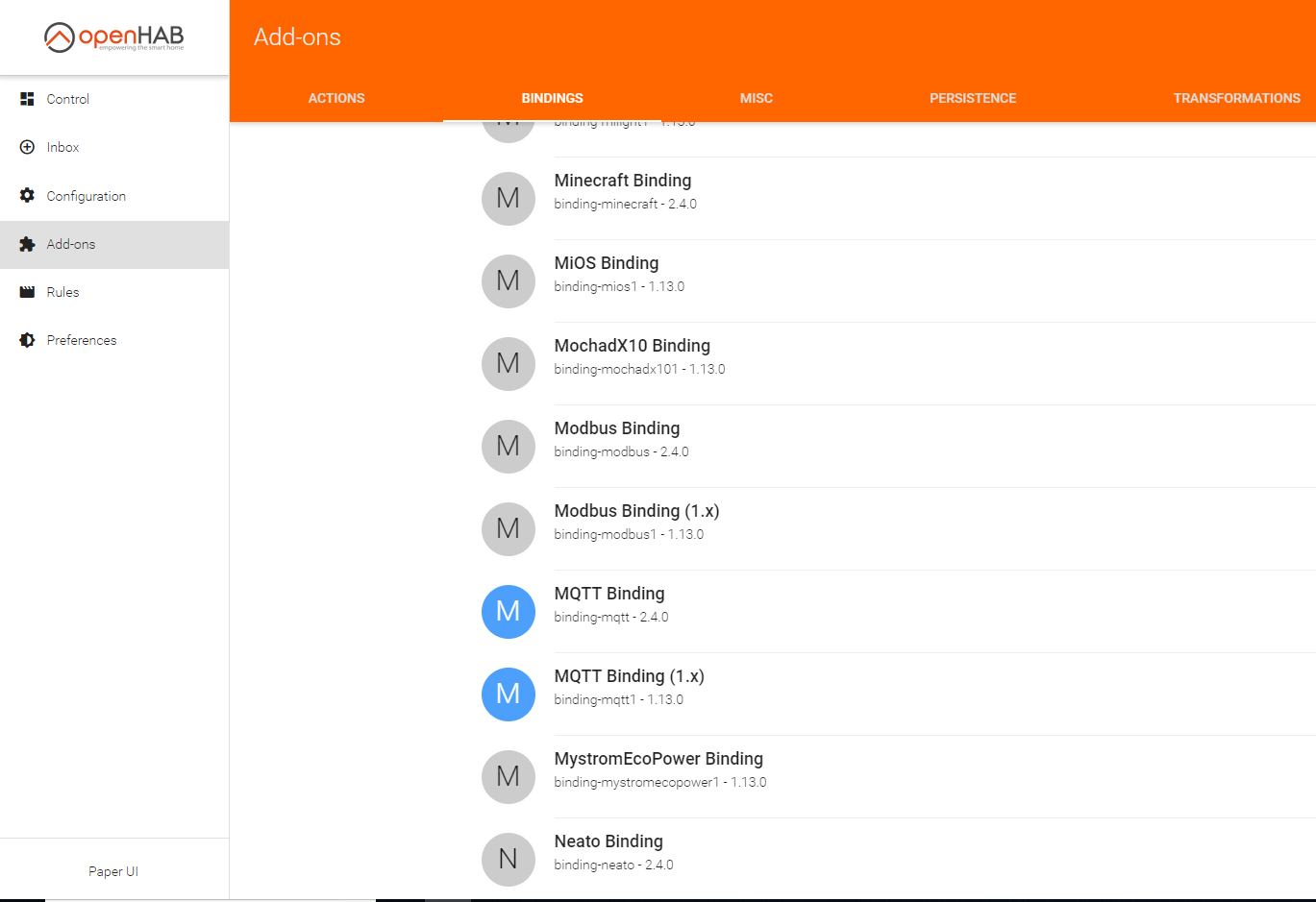

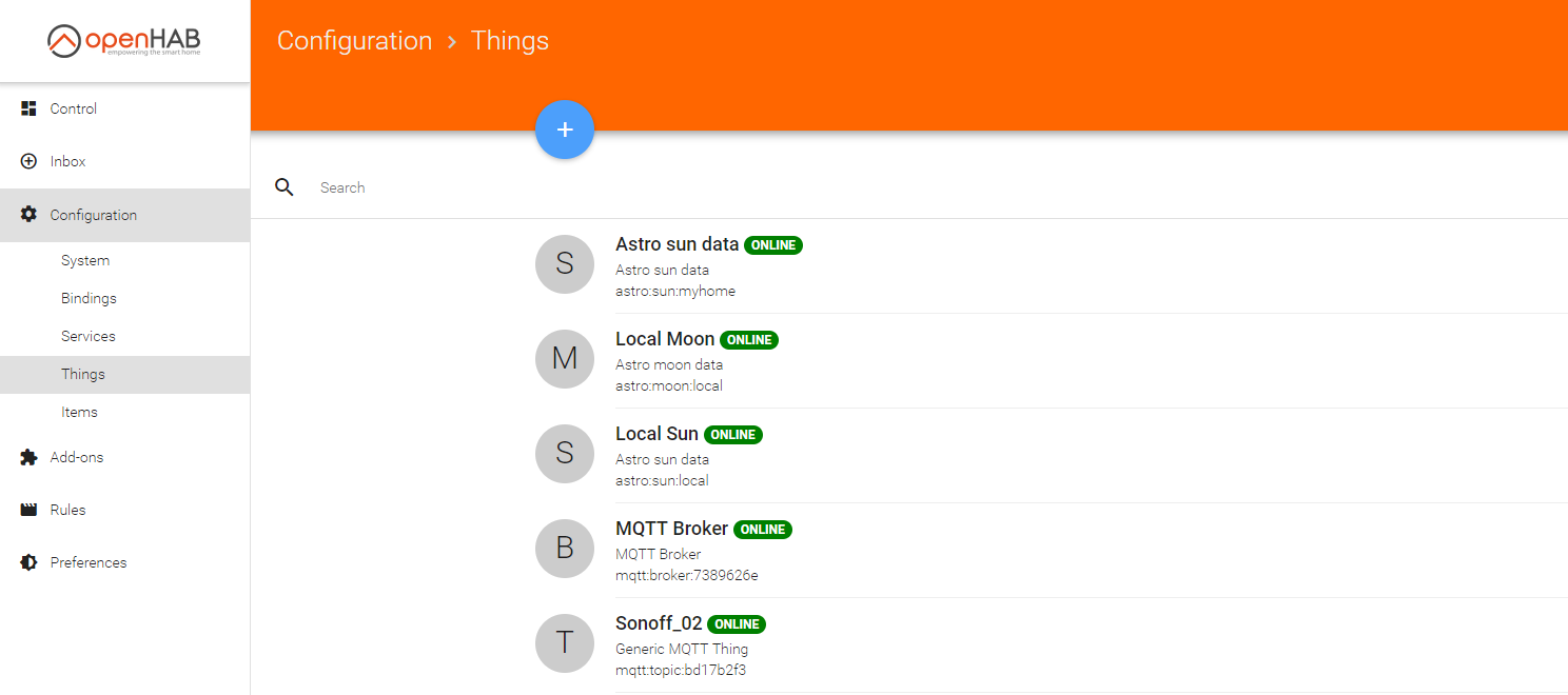

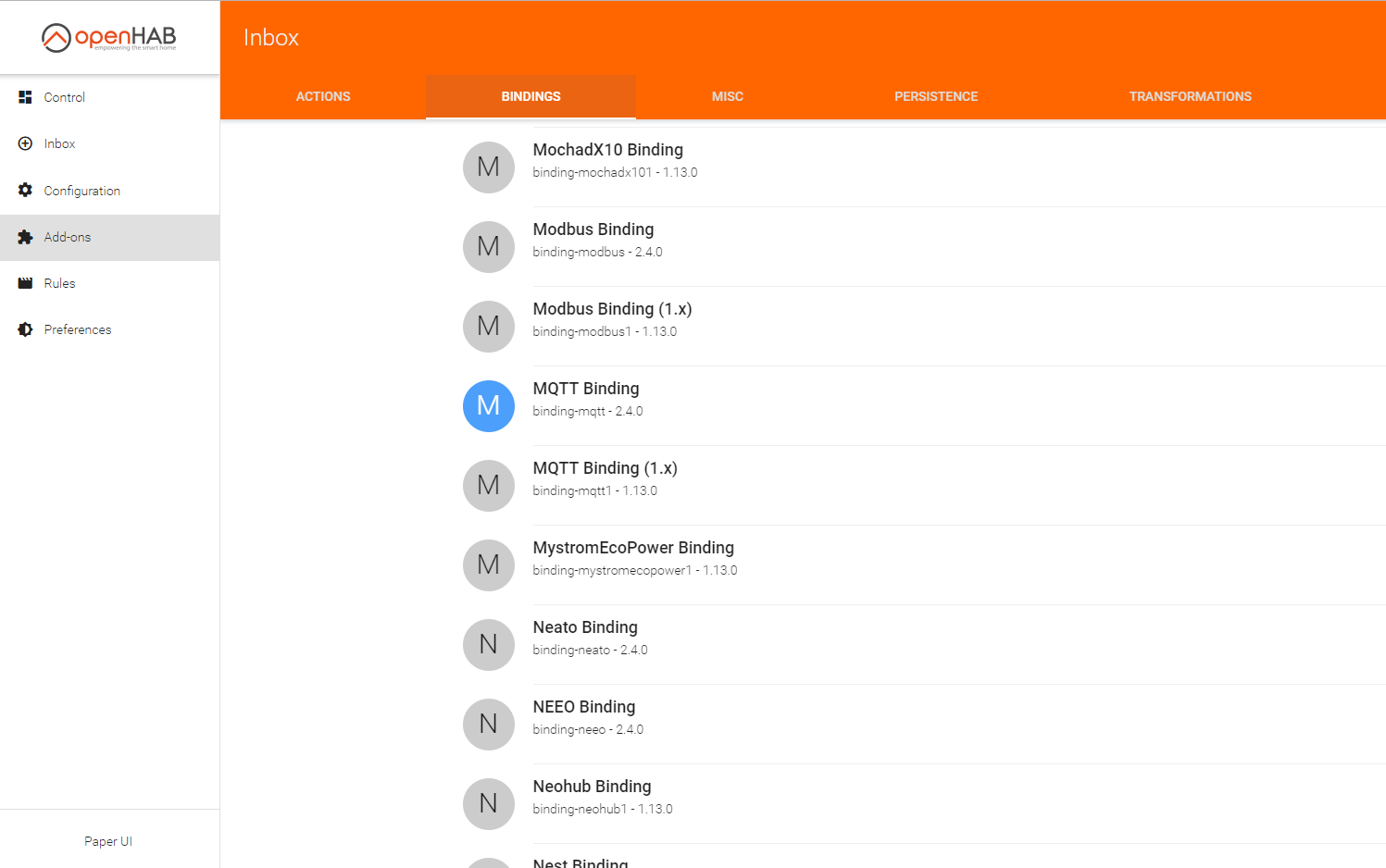

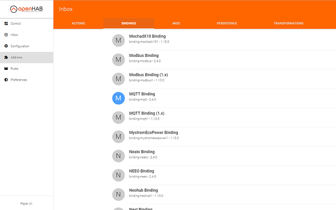

Maybe this helps:
sarpberry p3 b+
openHAB 2.4.0-1 (Release Build)
i have sonoff/tasmota
astro binding
mqtt

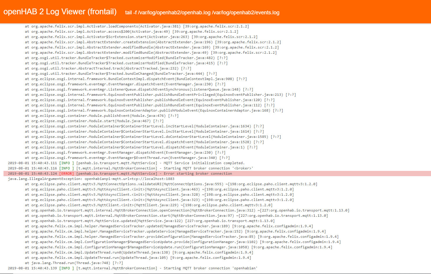

2019-08-01 09:35:01.616 [INFO ] [penhab.io.transport.mqtt.MqttService] - MQTT Service initialization completed.
2019-08-01 09:35:01.619 [INFO ] [t.mqtt.internal.MqttBrokerConnection] - Starting MQTT broker connection ‘’
2019-08-01 09:35:01.685 [ERROR] [penhab.io.transport.mqtt.MqttService] - Error starting broker connection
java.lang.IllegalArgumentException: openhabianpi-mqtt.url=tcp://localhost:1883
at org.eclipse.paho.client.mqttv3.MqttConnectOptions.validateURI(MqttConnectOptions.java:555) ~[198:org.eclipse.paho.client.mqttv3:1.2.0]
at org.eclipse.paho.client.mqttv3.MqttAsyncClient.<init>(MqttAsyncClient.java:463) ~[198:org.eclipse.paho.client.mqttv3:1.2.0]
at org.eclipse.paho.client.mqttv3.MqttAsyncClient.<init>(MqttAsyncClient.java:328) ~[198:org.eclipse.paho.client.mqttv3:1.2.0]
at org.eclipse.paho.client.mqttv3.MqttAsyncClient.<init>(MqttAsyncClient.java:323) ~[198:org.eclipse.paho.client.mqttv3:1.2.0]
at org.eclipse.paho.client.mqttv3.MqttClient.<init>(MqttClient.java:229) ~[198:org.eclipse.paho.client.mqttv3:1.2.0]
at org.openhab.io.transport.mqtt.internal.MqttBrokerConnection.openConnection(MqttBrokerConnection.java:312) ~[227:org.openhab.io.transport.mqtt:1.13.0]
at org.openhab.io.transport.mqtt.internal.MqttBrokerConnection.start(MqttBrokerConnection.java:97) ~[227:org.openhab.io.transport.mqtt:1.13.0]
at org.openhab.io.transport.mqtt.MqttService.updated(MqttService.java:122) [227:org.openhab.io.transport.mqtt:1.13.0]
at org.apache.felix.cm.impl.helper.ManagedServiceTracker.updated(ManagedServiceTracker.java:189) [9:org.apache.felix.configadmin:1.9.4]
at org.apache.felix.cm.impl.helper.ManagedServiceTracker.updateService(ManagedServiceTracker.java:152) [9:org.apache.felix.configadmin:1.9.4]
at org.apache.felix.cm.impl.helper.ManagedServiceTracker.provideConfiguration(ManagedServiceTracker.java:85) [9:org.apache.felix.configadmin:1.9.4]
at org.apache.felix.cm.impl.ConfigurationManager$ManagedServiceUpdate.provide(ConfigurationManager.java:1102) [9:org.apache.felix.configadmin:1.9.4]
at org.apache.felix.cm.impl.ConfigurationManager$ManagedServiceUpdate.run(ConfigurationManager.java:1058) [9:org.apache.felix.configadmin:1.9.4]
at org.apache.felix.cm.impl.UpdateThread.run0(UpdateThread.java:138) [9:org.apache.felix.configadmin:1.9.4]
at org.apache.felix.cm.impl.UpdateThread.run(UpdateThread.java:105) [9:org.apache.felix.configadmin:1.9.4]
2019-08-01 09:35:01.688 [INFO ] [t.mqtt.internal.MqttBrokerConnection] - Starting MQTT broker connection ‘openhabian’

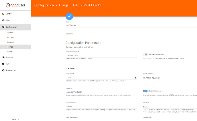

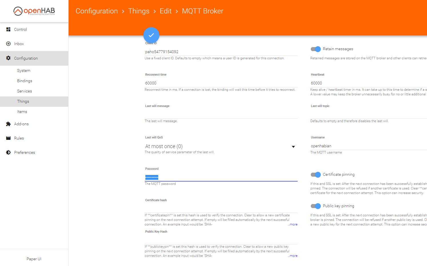

Could you post openhab.log ?
Are you using textual config or paperUI to configure the MQTT Bridge/Things?
If using textual, the *.things would be usefull too.
Are you using mosquitto? Or the build in broker?

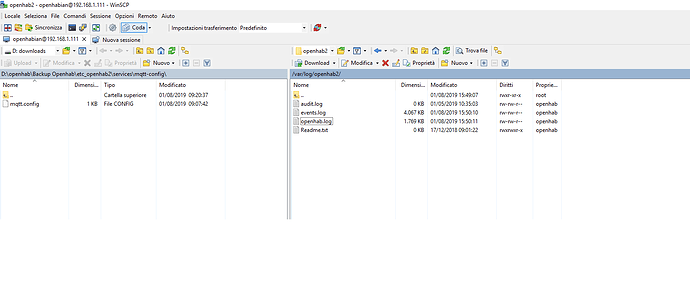

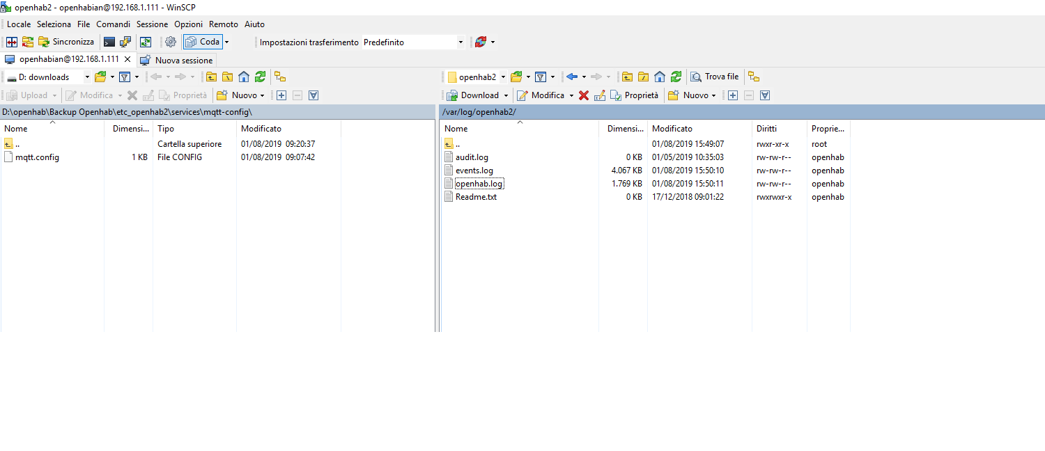

https://drive.google.com/file/d/1fxnc3-DX3BBJ4yzERc-29-KXwWFF0i9C/view?usp=sharing openhab.log
use textual config
use mosquitto
where is * .things

Later on it looks like you have two connections defined (’ broker’ and ‘openhabian’)
I guess the first one is some demo/placeholder and the latter is the actual one.
2019-08-01 09:35:01.619 [INFO ] [t.mqtt.internal.MqttBrokerConnection] - Starting MQTT broker connection '<broker>'
	[snap]
2019-08-01 09:35:01.688 [INFO ] [t.mqtt.internal.MqttBrokerConnection] - Starting MQTT broker connection 'openhabian'
I would suspect there is something wrong with your MQTT configuration in either paperUI, in textual config or both.

So could you post a screenshot of paperUI showing the MQTT bridge configuration (Configuration → Things → MQTT Broker → edit and click show more.)
At the second screenshot, it is visible that you have enabled 1.x and 2.4 MQTT binding.
That is probably the cause of two related messages in the openhab.log one about the ‘broker’ (error) and ‘openhabian’ (no error)
I would advise to uninstall the 1.x binding. And only use the 2.4 binding. From the log and what i can see it looks like the openhabian broker is the 2.4.0 version and that is working as expected. the Sonoff MQTT thing is listed and all are marked online.
ok i uninstalled the 1x I turned off and restarted here is the log file
You can drag and drop the log file in this post a reply window (if its not to big, er zip it) a full log would give a lot more to look at.
Could you double check there is only one broker under Configuration → things ? and check if there is a .things file in /opt/openhab2/ (i think that is the userdata fodler for openhabian, not sure)

this is event.log
You have to send the openhab.log (contains information about the system) not the events.log (contains information about data changes)
I really suggest you to read the documentation. Because you find it hard to provide the right files and find them on your system, i would suggest to do a clean install (if you haven’t done much yet) and start with some basic howto’s.
