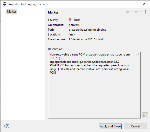

First time setting up the development environment with Eclipse IDE acording to Developer Guide | openHAB. When I import a test binding to give it a run and possibly try to add some new features to test, but I get the following error:
This also happens if I import one of the addons binding an try to run it.
Could someone give me a hand on this matter?
Thank you for all your help.
Best regards.
Edit: Just as additional info, I used the skeleton script to build a test binding from scartch and same error appears.
I don’t know what is causing this. It looks like a bug (or feature?) in eclipse 2020-06, probably m2e plugin. When installing 2020-03 I don’ have this issue and it’s also possible to build with maven on the command line. I have no easy solution other than install eclipse 2020-03.

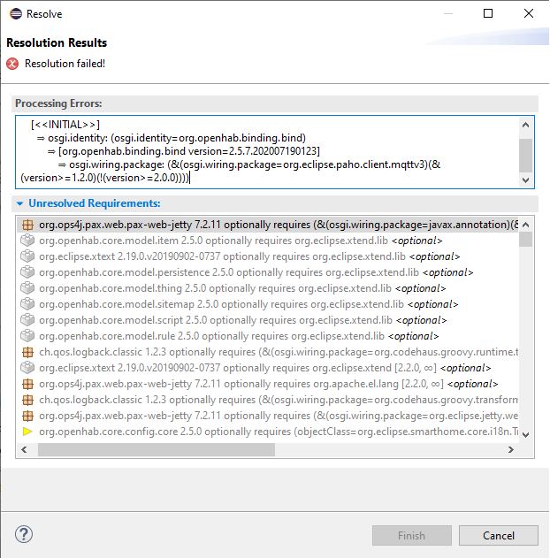

Now when I add the initial test binding to the demo app and press resolve I have the following error that I think has to do with a dependency, right?
I have the dependency added to the feature.xml and the binding builds correctly in Eclipse IDE.
Could you please help me to sort this out.
Thanks a lot in advanced for your help.
Hello again @hilbrand,
After doing some more reading and testing I added the dependency to the demo.app pom.xml file and marked the binding and the dependency to the run requirements. After pressing resolve the magic happened :slight_smile:, everything is running smooth.
