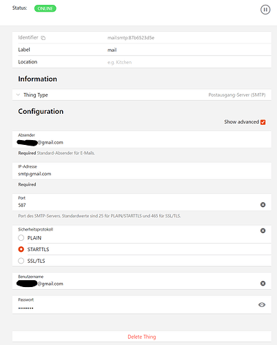

I don’t get the problem here. I’m trying to send mails via script but receive an error message which is described below:
This is the THING which I created:
Have this dsl script is created as part of rule:
val mailActions = getActions("mail","mail:smtp:87b6523d5e")
val success = mailActions.sendMail(".....@gmail.com", "Betreff", "Mailtext")
When executing the script I get the following entries in the log:
2022-04-03 10:17:24.613 [WARN ] [ab.binding.mail.internal.SMTPHandler] - Sending the email to the following server failed : smtp.gmail.com:587
2022-04-03 10:17:24.614 [WARN ] [ab.binding.mail.internal.SMTPHandler] - javax.mail.MessagingException: IOException while sending message;
nested exception is:
javax.activation.UnsupportedDataTypeException: text/plain; charset=UTF-8
GMail login settings in the thing should be ok, as I changed to a wrong password, and then the log returns a proper message.
Hope you can advice.
Many thanks!
