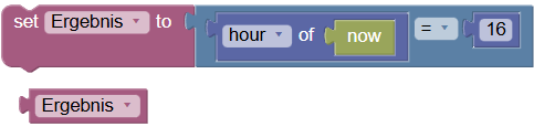

Try using a variable as a workaround.
var Ergebnis;
Ergebnis = ((time.ZonedDateTime.now()).hour()) == 16;
Ergebnis;
Hi and thanks, the workaround seems to be working.
