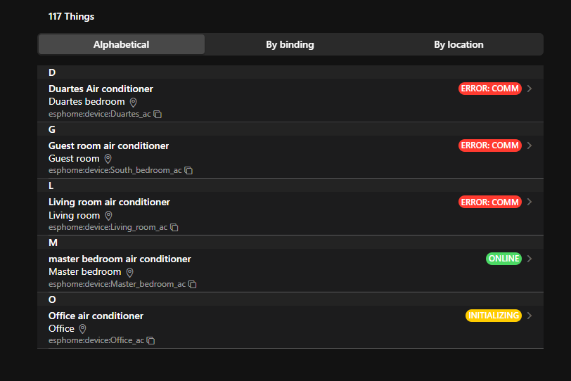

I might have spoken too soon. All my esphome devices are in various degrees of “unavailability”.
Error in thing:
COMMUNICATION_ERROR
ESPHome device abruptly closed connection.
Fun bit, restarting openhab fixes it temporarily. Weird but ok.
I’m looking at frontail and nothing jumps out as an obvious issue…

The diag command did not seemingly output anything, or maybe I don’t know where to look for it, can you provide some hints?
Also, I now have a worse problem… all of my esphome devices are constantly going offline and become unresponsive/unreachable. But one problem at a time.
