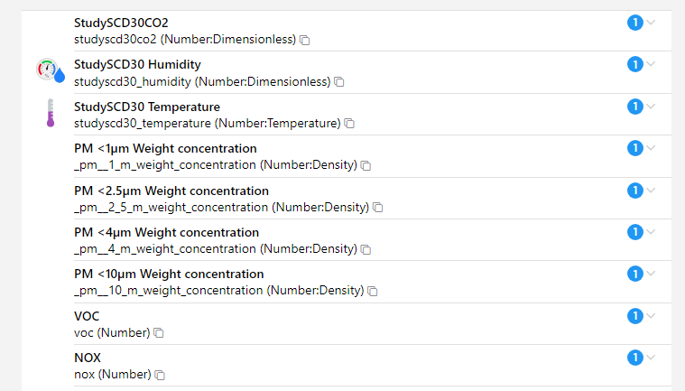

I have 2 climate sensors (SCD30 and SEN54) connected to and ESP32 board. Next to the basic yaml commands, here are the variables of those 2 sensors in the yaml file for the ESPhome config on the board:

Next you add an ESPhome Thing to Openhab containing the ESP32/ESPhome board with the sensors. Once added, these items show up in OpenHab:
And the variables of the ESPhome Yaml file show up as items in OH.
As mentioned, start with an ESP32 board, a couple of sensors and configure them with ESPhome via ESPhome.com. And if they’re working, connect them to OH.
