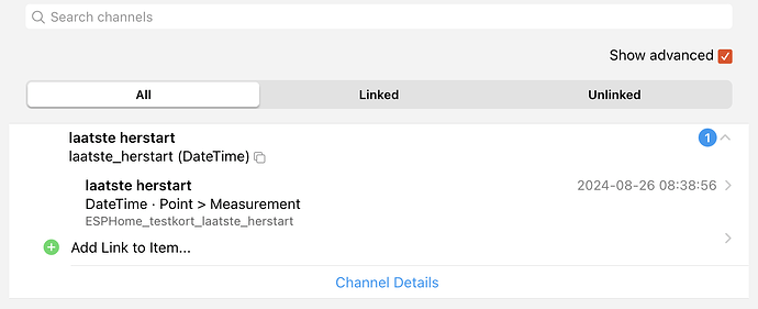

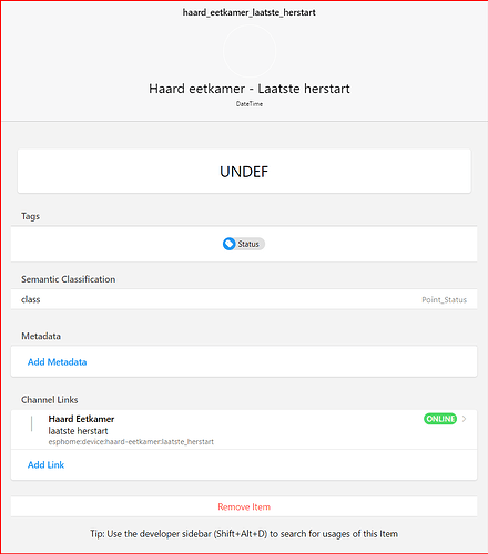

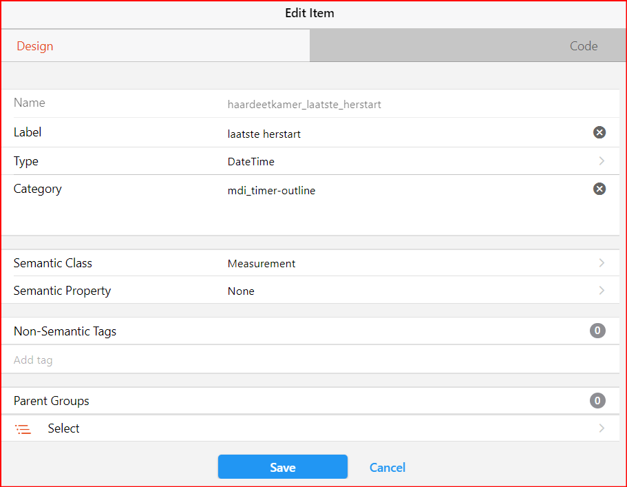

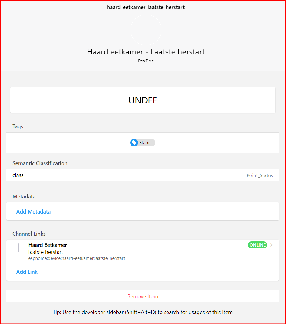

I tried integrating an Uptime Sensor, but the linked item reads UNDEF
time:
  - platform: sntp
sensor:
  - platform: uptime
    type: timestamp
label: laatste herstart
type: DateTime
category: mdi_timer-outline
groupNames: []
tags:
  - Measurement
Anyone any idea how to get it working? I assume there’s something missing in the [Time Component(Time Component - ESPHome - Smart Home Made Simple)?

Added support for sensor of type timestamp

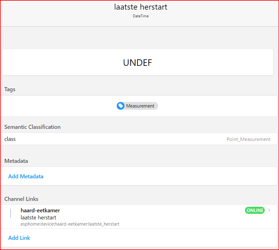

Should I use the latest jar, or is the latest version in the marketplace also updated?
@seime, I installed the jar file in the addons directory, deleted the thing, restarted openhab, unwittingly even deleted the items that were linked to the thing and finally re-added the thing (and recreated items of course).
But still…:
Any other thoughts? Is there any logging I can provide?

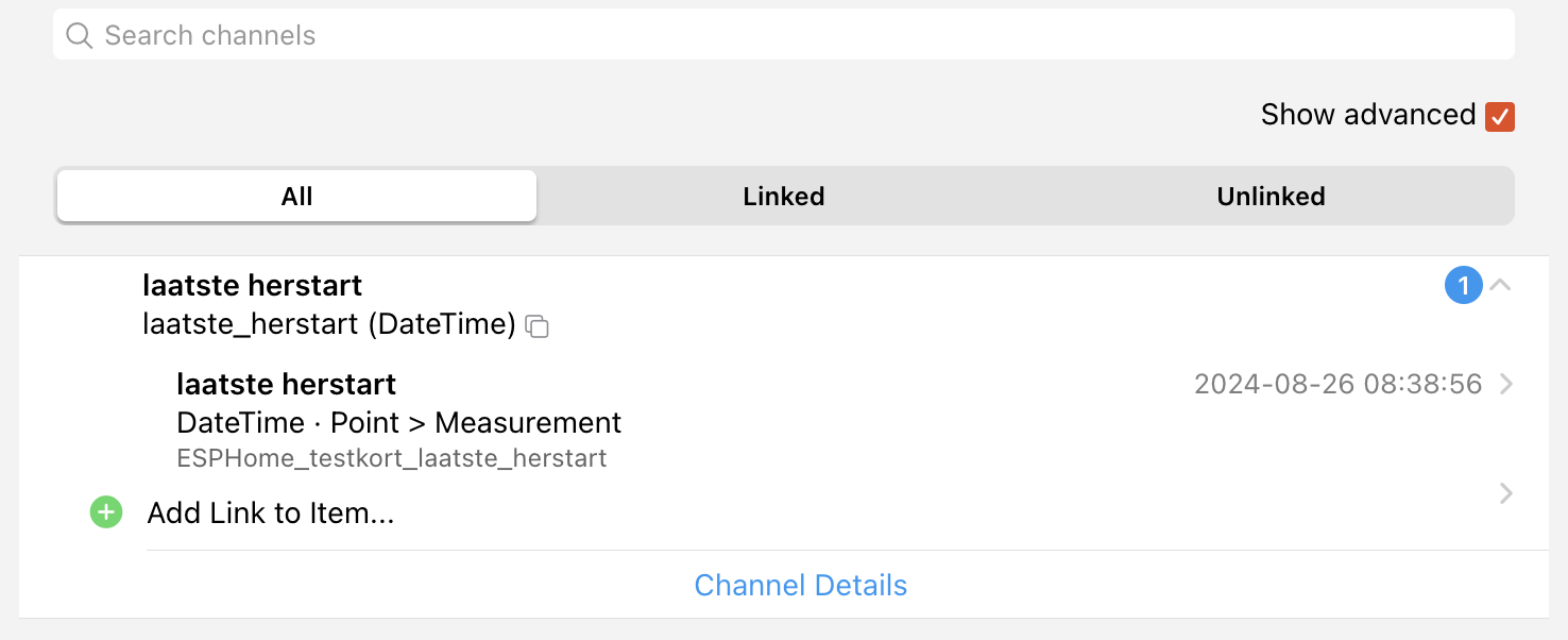

Then again, when I restart the ESP32, this is what I see in its logs:
[08:48:56][C][uptime.sensor:032]: Uptime Sensor 'laatste herstart'
[08:48:56][C][uptime.sensor:032]:   Device Class: 'timestamp'
[08:48:56][C][uptime.sensor:032]:   State Class: ''
[08:48:56][C][uptime.sensor:032]:   Unit of Measurement: ''
[08:48:56][C][uptime.sensor:032]:   Accuracy Decimals: 0
[08:48:56][C][uptime.sensor:032]:   Icon: 'mdi:timer-outline'
[08:48:56][C][uptime.sensor:033]:   Type: Timestamp
So maybe there’s something wrong with my yaml?

I changed sntp to homeassistant, and now it works:
time:
  - platform: homeassistant
Maybe your ESP is unable to reach the sntp servers? The homeassistant source fetches time from openHAB, should work fine

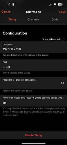

Oh one weird issue I’m having is that every once in a while the hostname gets replaced by the .local one published by the device (I assume):
In this example I have the IP (I use IP because the .local domain doesn’t work on my network setup). Would it be possible to have a way to make the IP stick??
Is this the same problem as last year? ESPHome binding for the Native API [4.0.0;6.0.0) - #29 by seime
If not, logs are needed!
Yes! Only, it’s not reproducible.
Or rather, for the last two days everything was fine, today I had one ac down and when investigating it had reverted back to the .local.
While not related to the binding, I’ve noticed that the controllers I bought seem to restart somewhat frequently. Could it be a “when offline revert to .local and try again”? Situation? After which it stays with the .local? Maybe an esphome behavior?
Just make sure your things doesn’t have the same thing uid as the discovery result (with the REMOVEMEWHENADDING text). Or it will get overwritten unless you use thing files.
