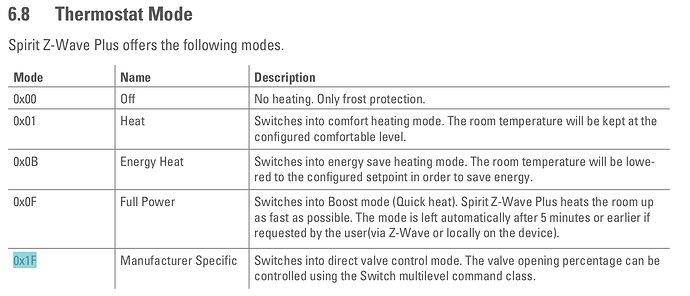

If I understood the manual right, there is no “manual”-state available. Only the 4 in the xml file. Seams all is OK.

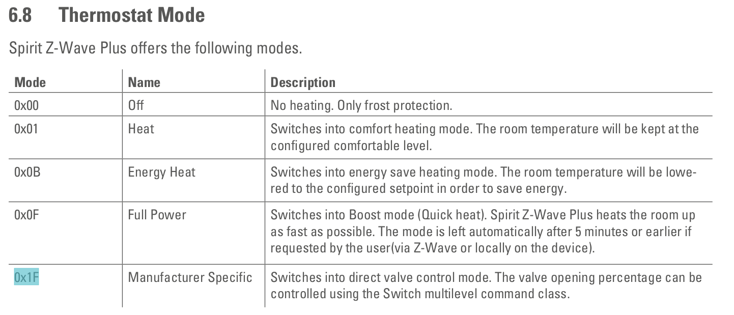

Extract from the manual
untitled
That’s what we are talking about. Manual control of the valve.
You are right, I misinterpreted this.
Can you verify this, please?
Since snapshot 1443 I get no temperature value any more. Channel is there, but no value received from device.
This topic is about unsupported mode type 31 of the Spirit Z-Wave Plus.
Please open a new topic with your problem. I’m sure you’ll get answers … :wink:

I just checked the file that @FraPi provided, which only has the following mode types for COMMAND_CLASS_THERMOSTAT_MODE :
<modeTypes>
    <modeType>HEAT</modeType>
    <modeType>HEAT_ECON</modeType>
    <modeType>FULL_POWER</modeType>
    <modeType>OFF</modeType>
</modeTypes>
So indeed Manual seems to be missing here.
