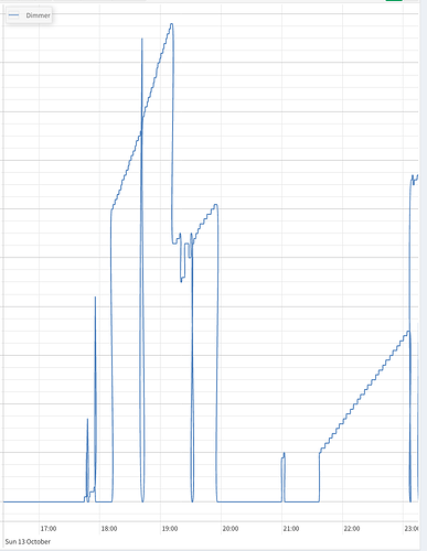

21.4 °C room temp (the value the Spirit has).
20 set temp.
15% valve open (that already heats 100%).
I set the Set temp back to 19:
Valve opens to 100%.
2 times I set the mode to Off / Heat: switches between 0 and 100%.
Again I switch to Off, and back to Heat: This time the valve opens 15%.
Completely random, unpredictabel, very expensive heating costs, and a room that is too warm. Useless stuff without direct valve control.

Yes, controlling the pump in parallel could be the difference - I can’t control the water flow in my flat.
In theory I could script a rule for OFF / 30°C, but that’s what I have with my FS20 regulators, and I’m still not sure if that would really do it, and I actually don’t want it that way, for reasons. :slight_smile:
Yesterday the valve even opened while the mode was set to OFF. Restarting OH seems to have cured it.
I also did the adaption process of the Spirit again - which always failed, until I removed the batteries.
I also excluded it, removed it from OH & factory reset, to start over clean…
Side note: Charts (generally) do not really work (one of the many oddities I have with OH / HABmin). Maybe because I run it on a Mac.
I tried to graph the room and SET temp, and the dimmer, but it graphs at best the dimmer, and this is an example what the valve does, although the set temp is 3°C below the room temp:
37
I also realized that I couldn’t rely on the state shown in OH - I hear the valve moving, but it’s not updated in OH, looks like the Spirit does not report when the valve does it’s ā€œsecret magicā€. So I set the polling time for the device from 1 day to 30 seconds, now the valve’s state is updated in OH reliable within 30 seconds and I see the irregularities better.
