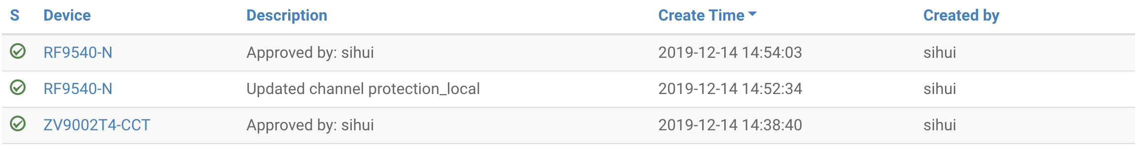

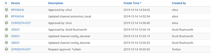

When I do database changes the timestamp is already 1 hour behind. Some Daylight Saving Time issue?
The times in the history were correct based on the times I received the emails. But even then, it doesn’t show in the log at all - the only one that shows around this time for you is this cooper device and the time is just a few minutes before you sent the message here to say you’d updated it… (database logs 14:54 and your message above saying your added it was at 14:56). The email I got at that time was also for the Cooper device…

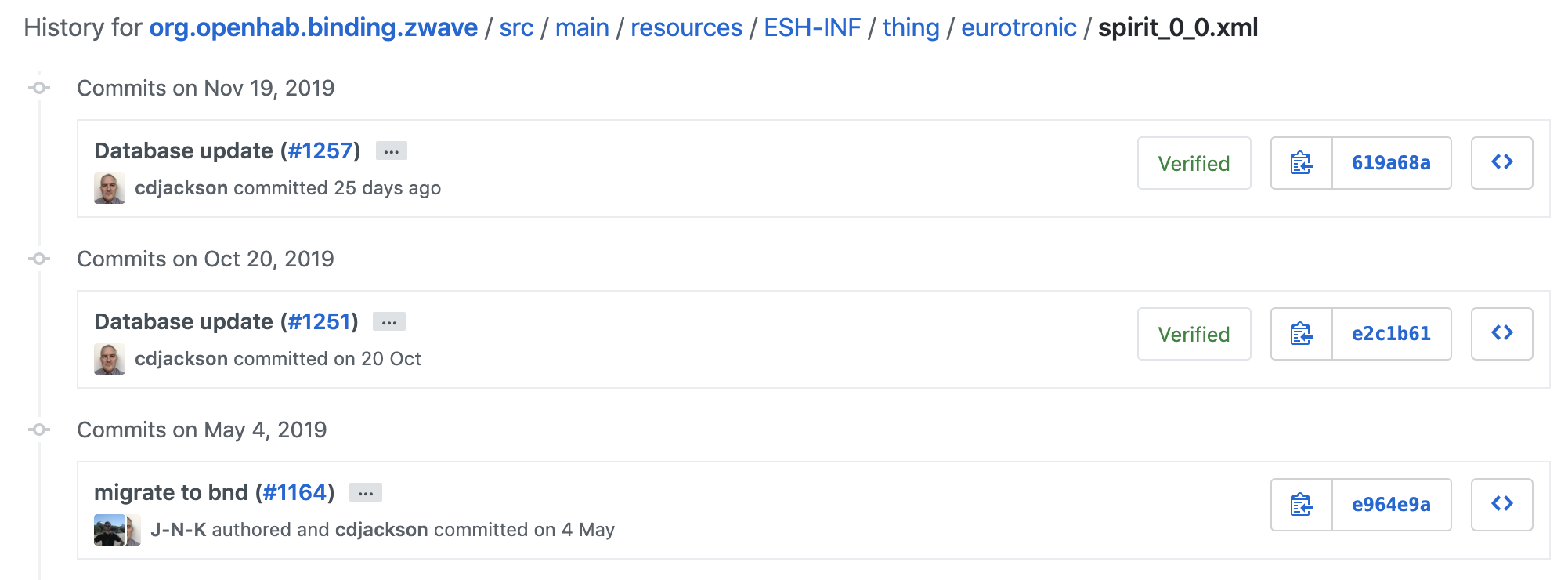

If I look at the database for this device, it’s not changed for nearly a month. This is consistent with Github which also shows no changes for a month.
I guess it doesn’t matter, but it’s a bit strange as it definitely points to you adding it to the cooper device, not the spirit. I thought it might be some sort of issue with the history logging, but I don’t really think that explains it either.
