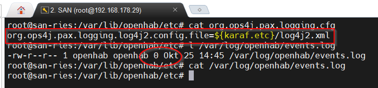

/var/lib/openhab/etc/org.ops4j.pax.logging.cfg:
org.ops4j.pax.logging.log4j2.config.file=${karaf.etc}/log4j2.xml
Same here, events.log is empty.
openHAB has been installed on 25th October 2021… no content…
As you see, the *.logging.cfg has the mentioned correct content, but the log is empty:
System has been rebooted today, nothing changed.

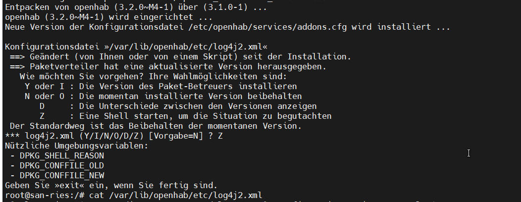

During migration of 3.1.0 to 3.2.0.M4 I recognized the following prompt for log4j2.xml, which leads to the assumptions that something important has changed (maybe not)…

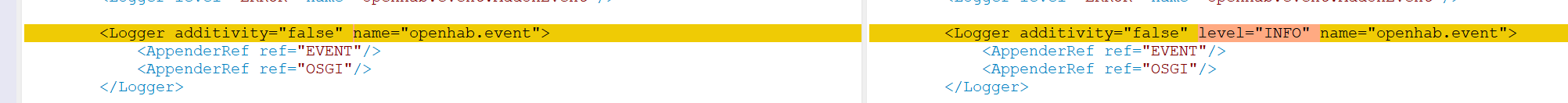

One diff is:
An other diff (which I guess is much more important) is:
I can not remember that I have added these line of code.
I have to admit that I played around with some examples from the web at the beginning of starting with openHAB in October’21. In addition I do not really know why <Logger name="openhab.event.*"/> has to be removed, that line sounds important.

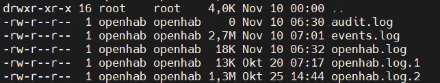

Anyway, right now I get logs in events.log:
By the way, in other posts zram and frontail are mentioned as reason for this cause. This can not be case for me, both are not installed or configured. I am not using any prepared image/distribution. I use the Linux packages with apt-get (see Download openHAB | openHAB). Not the snapshot, I am not that brave enough :rofl:

BTW: Not clear which is the current/new and which is the incorrect/old in your diff screen shots?
My file (working) has (same as the GIT source above):
		<Logger additivity="false" level="INFO" name="openhab.event">
			<AppenderRef ref="EVENT"/>
			<AppenderRef ref="OSGI"/>
		</Logger>
So guessing that what changed was adding
level="INFO"
