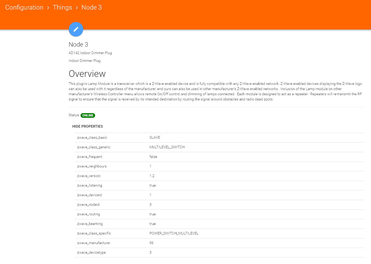

  • Included AD142 Dimmer Plug (as a Thing). It’s showing as online, I can see it’s properties, I can’t see any channel.

What exactly is shown in the UI? What are the properties shown? Can you provide a couple of screenshots?
Sure, here it is. Let me know if you need anything else!
3%20-%20AD142-3
Thanks. All looks fine - I’m afraid I’m not sure why it would show no channels. The database looks fine, so I don’t see any issue with the definition. I would check to see if there are any errors in the logs - I think in general once the thing type is set, then the channels should be displayed without any input from the binding (ie the system does all this based on the XML file, which looks ok).
I guess one thing to check is that the thing type is correct - this is shown in the things list. I expect it is, otherwise you probably wouldn’t see the name etc that is shown in the above image.
