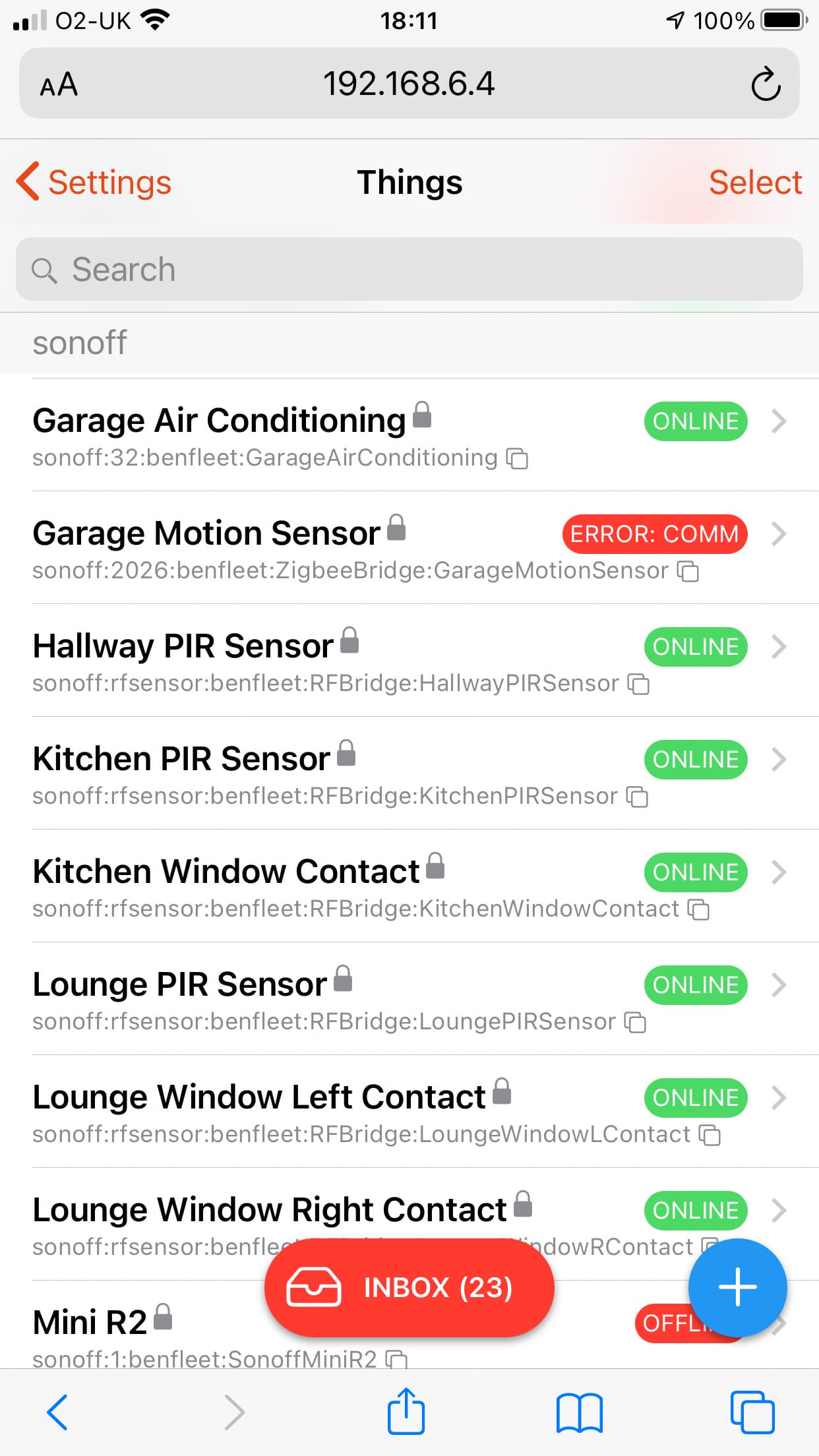

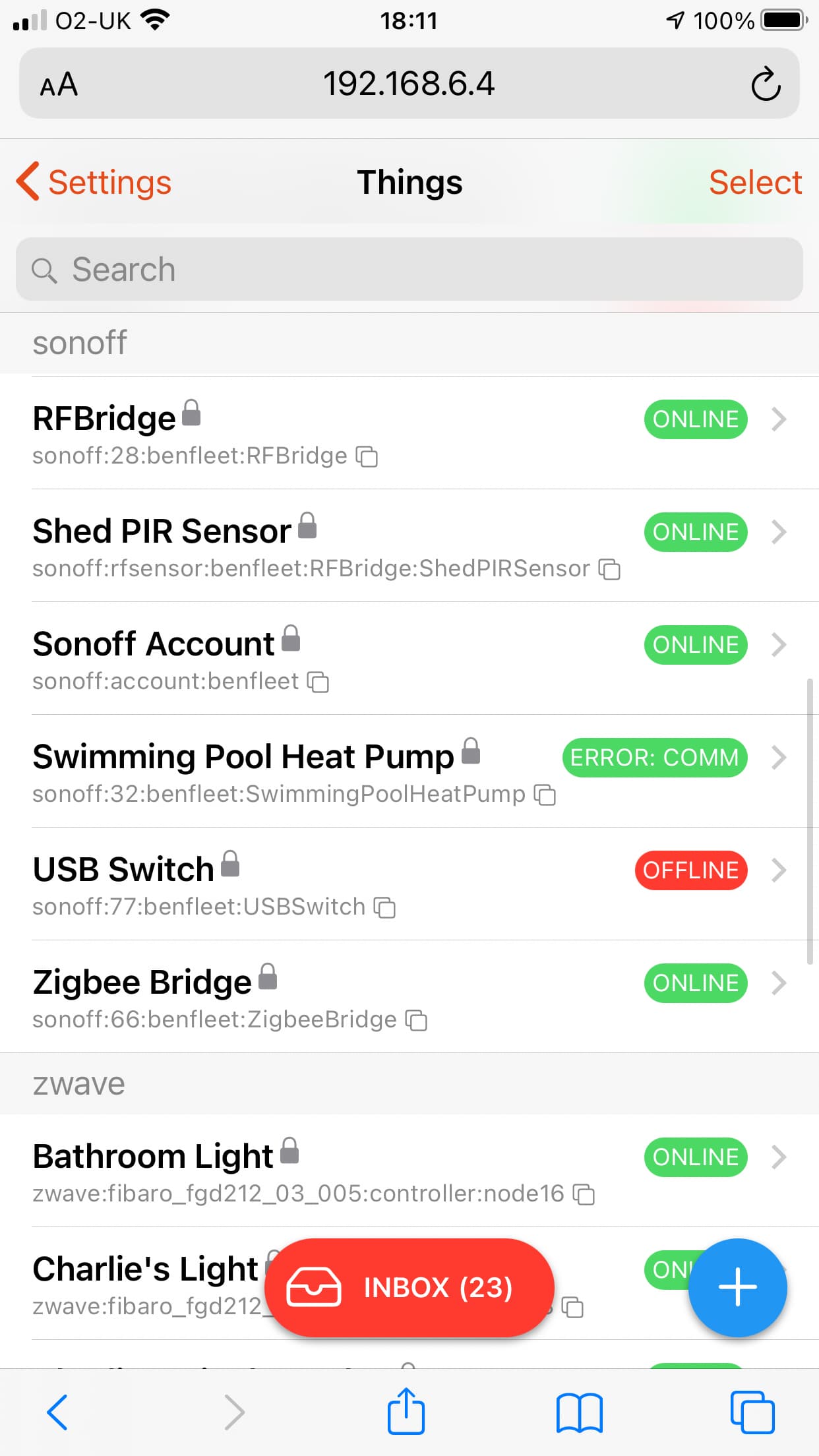

So have just loaded up the latest 3.1.0 Stable release and with https://github.com/delid4ve/openhab-sonoff-compiled/blob/main/org.openhab.binding.sonoff-3.2.0-SNAPSHOT_2.5r6.jar
It loads up fine and I’m able to add all of my things (some are offline as they are not connected for testing only):
